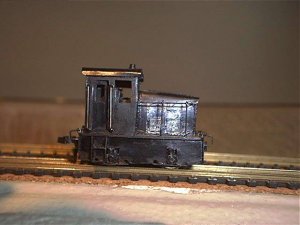

Here's a photo of one I built from the article in MR.
The shel is sheet styrenethe hood dors are embossed foil.
The drive was built from scratch.
