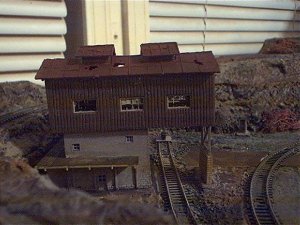

trains1972, strip and sheetwood is cheap as is elmers. This coaling tower cost under $15 in supplies and was a load of fun to build. Give wood a try. :wave: :thumb: :) Or look at something done by Mathyro. He uses cardboard and elmers which is as close to free as you can get. ;)

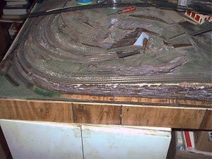

I do have the section ready to build a city on. I could try to build row homes with wood. I was going to put the streets and sidewalk in on my layout before I built the buildings. Anyone have any ideas how to put streets and sidewalk in cheap. The street has to be 1/4" thick to become level with the track the sidewalk 10mm higher. Here is the area that the city will be in.

There are lots of ways to do roads. My favorite easy methods are 1. use matte board and paint it with acrylic paints after cracking and sectioning it with a ball point pen. The pen depresses the paper and after they are painted and weathered with ink/alcohol they look like cracks. If painting the streets just put straight hobby acrylic in the middle of the road and brush to the edges. Gives a broomed concrete look after weathering.
Another way is to go to hobby lobby, or such, and get scenic sand like they put in bottles. It comes in black and gray which are two great colors for roads. Mix up about 1/4 elmers and 3/4 blue windsheild washer fluid in a spray bottle. Spread the sand to make your road and then mist it with the glue mix to wet it, then spray it harder until you soak it and puddles are standing. The misting at first freezes the surface so it don't move during the heavier spraying. Then put a fan on it (optional) until it dries, (a day at most). Then weather it and stripe it. Now it will be so hard you can sand wood with it. Those are my pet methods of cheap roads.
I build up by gluing on cardboard layers. After the glue mix it too become hard as brick. Sidewalks, I have also cast them from plaster in a mold and liked that too. The mold was made from painted stripwood and the bottom with packing tape covered cardboard. he sidewalk can then be scribed for cracks and washed with watered down tan/gray paint mix to taste. Fred

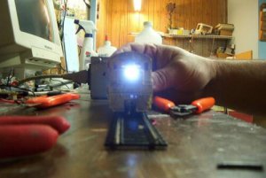

Today I put white directional LEDs in my little yellow sw 1500+ Fred

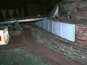

Yesterday I ripped up and replaced some bad track.
The rails had seperated from the ties on this section.

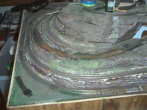

I had an insulation gap cut into the rails on this curve that was causing derailments so I removed all the track to this point.
Ray Marinaccio
I also removed this section of track on th ramp to realign the curve.
The track is reinstalled on the lower main line in this photo. I moved the insulated joints to the straight track.

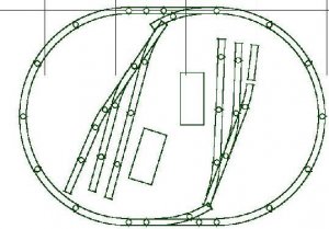

This is my first post. I'm getting back into the hobby and intend to take it seriously this time! Well, the last time was when I was 8 and had no clue how to make a nice layout.
So, to ease back in and hone some skills, before I tackle my planned model of the GTW Romeo subdivision, I am going to make test track, where I will have a place to test run locos I get off of eBay, test some handlaying of switches and work on ballasting and scenicking before diving into a bigger situation. Simply, here's what I'm going to do:
Build an oval of track in as small a space as I can with my old snap track. It will have two ladder yards, used for switching or industrial spurs, depending on whether I'm coming or going.
Use a piece of OSB I have sitting around. I will put masonite under all of the track and some sort of cork or foam roadbed for the oval "mainline".
I can build up and test ground cover techniques on this before I move to the bigger layout, and I can get locos and rolling stock working well in the mean time. The layout is below, and I know, the radius after the turnout is horrible. I bought one piece of flex track and I'll use it there, and fiddle with it till it works.
I was inspired to do this by the website for the Micro layouts. What a cool site.
So, I'm cleaning and laying old track and getting old and used locos and rolling stock back in working shape.

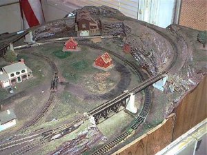

I made some progress with the landscaping and painting.
I have the base colors down and I'm almost ready to put down the ground cover and ballast.
I haven't decided if I should pave the road or make it a dirt road.

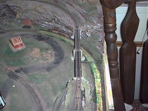

I gave the mine a wash of black acrylic then blended the base into the layout with drywall joint compound and gave the compound a wash of paint.
