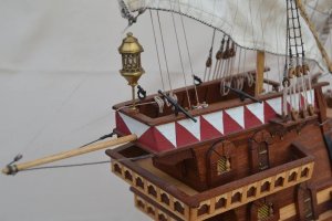

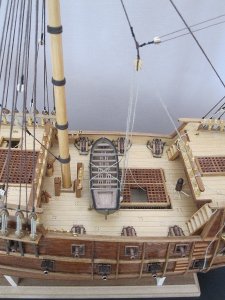

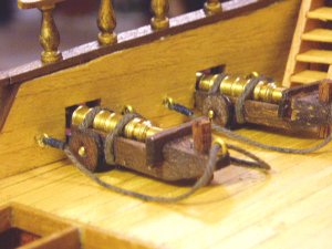

The cannons, how many? where they four wheels, two wheels or sliding cradles. the plans have two gun ports but I have seen references to 10 cannons, 5 for each side. and the possibilities of wheeled cannons in the rear covered areas, Life boat and a cover for that big open hatch. Also the swivel small cannons which were usually mounted at the aft deck.:wave:
silveroxide
Thanks, The first photo is of the early cannon carriages with the two wheels. Those in the photo are over simplified but is close to what the gunports would accommodate, plus the size of the crew standing by the rails make this version feasible. The bottom is of a full size royal Galleon with the lifeboat stored width wise. In this smaller galleon, I believe the lifeboat was stored centered front to rear. But the last photo showed something I totally forgot, the water bilge pumps next to the center main mast. I am still gathering more stuff, before I start to close up the sides. I need to do these things first
silveroxide

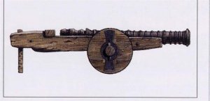

Those were used on small boats like a dinghy but I got the one I will use These fall within the time frame. Thanks and I will save it in my files for another small gun boat.

That is a good reference photo of the ship and it has two gunports. but the dinghy is front to rear as I envisioned it, and slightly of center to the port side. Thanks for the pic.
I imagine this ship must have changed it's appearance often during it's life and during it's missions. Scary thin g to imagine being on a dingy with someone pointing a Blunderbuss, mounted on a pivot at you!! :)

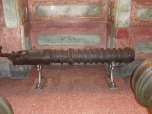

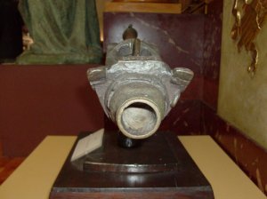

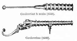

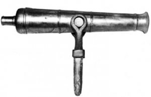

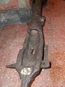

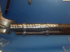

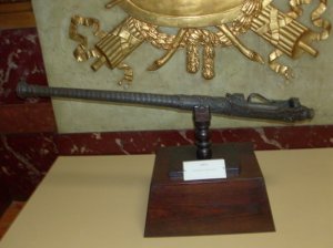

Interesting details on coulevrines (colibrinas in Portuguese). One of the most interesting aspects of this light gun was the use of a breech, quite obvious on the one dated form 1460 in the last image.
The other coulivrine dated from 1440 "coulivrine a main" translates for handgun, meaning an infantry weapon muzzle loaded. It would surprise if used on board ships.

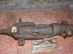

Last year I took some shots in Museu Militar en Lisbon of colibrinas dating from the XV century. The breech is missing but it is easy to understand how it worked. The metal triangular edge was destiend to lock the breech safe in place.

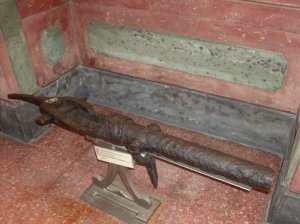

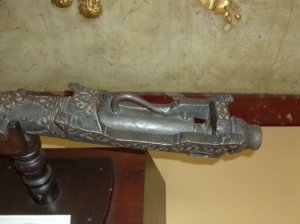

There was also a lighter built gun called a "berço" (direct translation= cradle). I would say it is from a later period than the XVth century. The breech is still in place.
I suspect that the cavity at the end of the gun would serve as attachement for a wooden pole to help as a butt.
The "berço" seems to be casted in bronze whilst the colibrina was in iron.
The Museu Militar of Lisbon has an appearance of a palace, but it was in fact an armory from the XIth century. The cellar still retains the original characteristics. Probably when built would be at ground floor and near the beach. Ships geting ready to sail would come here to load weapons and ammunitions.

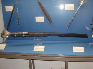

Just found a photo from a handgonne, displayed in the same Museum. It is in the hall dedicated to the civil war 1382-1384 and the subsquent invasion by Castilla (the kingdom that conquered everything in the Iberian Peninsula except Portugal). I read about the limited use of firemarms in this period. It is out of this thread, but thought interesting to show how it looked the first light weapons. Actually they started to appear in Europe already in the end of the XIIIth century.
