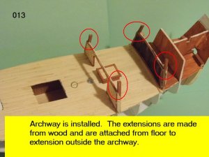

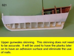

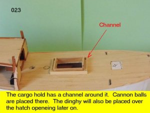

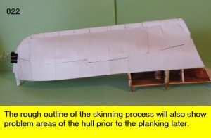

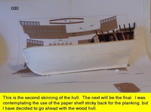

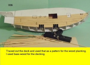

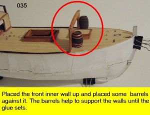

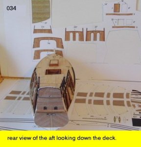

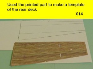

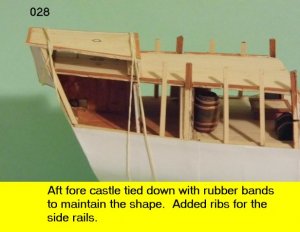

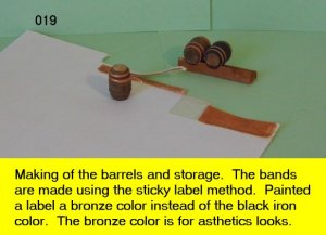

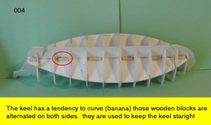

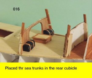

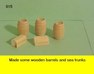

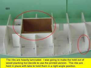

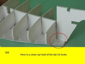

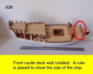

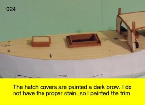

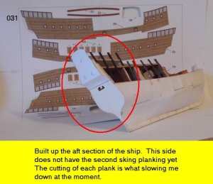

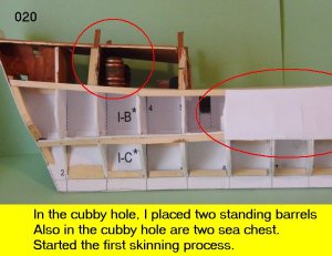

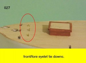

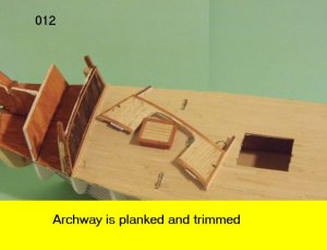

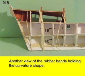

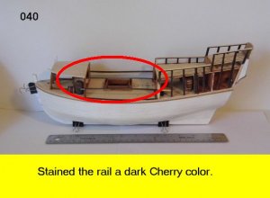

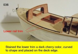

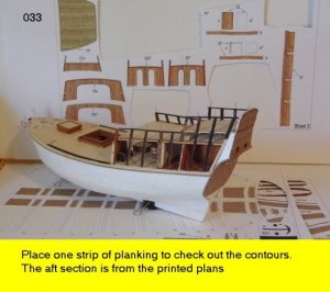

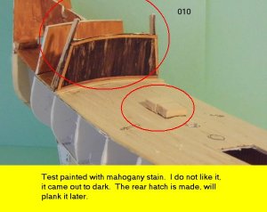

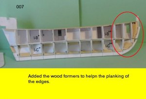

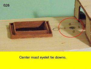

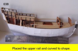

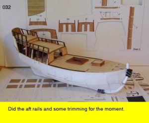

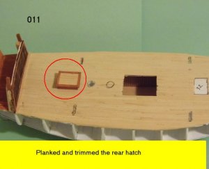

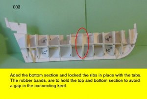

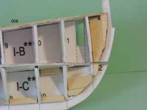

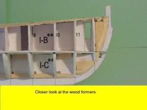

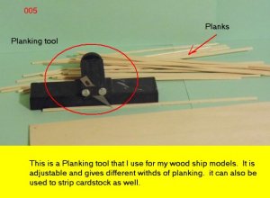

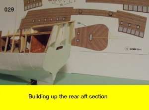

Continuing with another build, I hope to have it finished by the Holidays. My initial finish date was for Thanksgiving but I do not believe I can accomplish that. This model will be a mixture of cardstock and wood. The decking is almost finished and the rib sections are heavily laminated to almost the same thickness as a wooden model. The hull will be a mixture of wood planking over a cardstock hull. There is some slight fit problems with the ribs but they are easy to overcome. I will treat this build like a wood model from Artesania Latina. Here are the first photos
