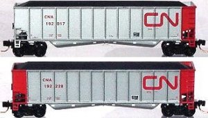

Topo - The only RR cars I am familiar with that have to be a certain way are the rotary coalporters. They have a rotating coupler on one end only (usually the one with the differently colored end). They must all be the same way to be able to offload the coal. They do this by going through a 'cage' that will rotate individual cars upside down to dump them. Usually the first and last car have two rotating couplers. This keeps them from flipping the engine or any following cars behind them.
The pictures are Nscale models, but they show what I mean. The top car has one rotating coupler (one stripe) while the bottom car has two rotating couplers (two stripe)
