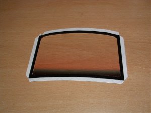

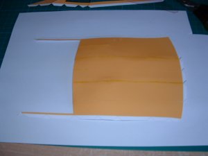

Thebodymechanic
I really appreciate the pic, great angle. Could you possibly take another one from the other angle, so I can see where the other tabs are to be glued? I know other parts have to be glued to it and I just can't figure out exacly where the other tabs go. By the way, your build is looking really nice and your pictures come out very clear. I can't wait to get to where you're at. Another question what type of paper are you using, it really stands out and it may give it a different look once completed. metal, diecast look Keep us informed with your awesome pictures, it really helps with the builds.
Thanks again,
Jav:drag1:
P
paulhbell
I'm using glossy photo paper, as you can gather from my previous posts, it's a nightmare to keep clean.
I'll try and take a couple of better photos tomorrow, in daylight, I might get a better result. I have to use the flash at the moment and it just flashes back of the white paper.

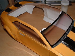

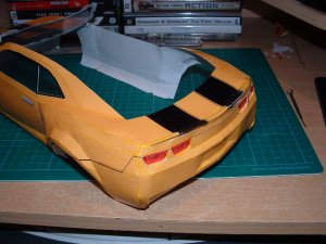

paulhbell
Thought it was time to spend a bit of time on model the car, instead of tinkering with my real car.
Nearly finished the passenger side of the car, just windows to glue on and a small bit to glue on the rear wheel arch. Also started putting the windscreen on. And rear end nearly finished, just exhaust pipes and number plate to put on. Take your time when making the rear end, the spoiler ends are a bit tricky. I rushed it a bit to much, all went together ok though.
I would not use glossy paper to build a card model again, it's a bloody nightmare to keep clean. I think I've said that before though.

P
paulhbell
Coming along faster now.
Bottom and drivers side of windscreen attached to car now, the passenger side windows and frame is nearly done and got I got the roof finished.
Still no issues with the car and it's starting to 'strengthen up' a bit now the parts are all joined together. It was a bit flimsy, until now.

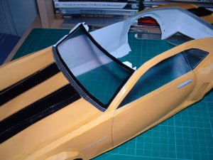

P
paulhbell
Sebret, I used the tabs that skip included on the sheets. I was going to use my own tabs, but I decided to colour the paper joins with yellow felt tip pen. It's visible in the photo of the roof.

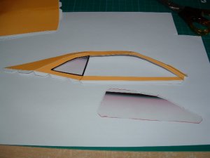

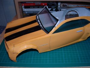

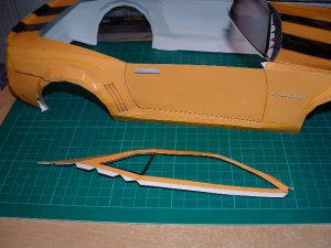

Thanks for the comment skip. Hard part comes soon, Joining the inside the the car body.
Pics of the rear window and frame, the last window now done.
And a photo of the body showing the windscreen glued in place. Needs a bit of a clean and the paper edges need colouring.
Only the rear screen and roof to fit. And another 2 wheels to finish.
