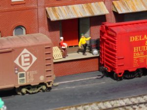

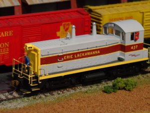

I used a 150 watt halogen flood light that we had around the house.
I do have daylight tubes but they are spaced appox. 4' apart.
I will add more tubes and incandescent track lights.
Thanks,
Marty

I wanted to confirm that lighting was part of my problem and not the camera. I did not want to add more lights in the room for nothing. Lucky that I only have a very small portion of the layout's scenery done, so hanging more lights will not be that hard. I hope.
Marty
Halogen worklights make great photofloods and even the ones that come with their own stands are fairly cheap. Their main drawback is the heat they give off. Some of them get so hot that they could be downright dangerous in a photo shoot. But it you've ever used the old blue or white photoflood bulbs in reflectors, it's about the same.
