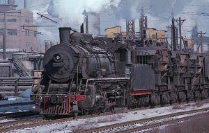

I found this pic on the net that I really like, and now I'm thinking I need more light colour on top. What do you think?

Val, I can't say, I would suggest painting it the way you prefer, both are prototypical. In regard to your last post concerning the photo and a lighter color on top, I just had a conversation with Blake about this the other day. He told me he tints the black with blue and sprays this on the boiler top from above. This is to add the effect of "outdoors" (reflecting the sky). It is subtle but effective.
Val,

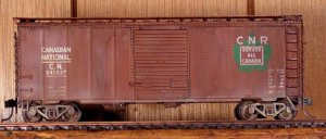

I was going to comment on the pic, when I saw Gary's reply. some of that "lighter color" is sky reflection (locomotives were glossy when freshly painted). I have seen some of Blake's work, and didn't realize he had done the tinting. "Subtle but effective",very definitely!
One thing which helps a steam loco model look far better is to eliminate the bright shine of the sides of the tires (the surface of the tire, and the flange would be "highly polished"), and the side, and main rods, and valve gear.
The box car is beautifully done! Can't wait to see the loco when you've done everything you wanted to it.
