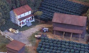

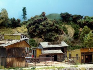

For those who are curious, I'll post a couple of pictures I have (many of you have already seen these:rolleyes: ) of corrugated metal "rusted" with Etchant.
I don't have any photos of metal "rusted" with my new method, but if I get a chance this week I'll take a couple and post them here.
In this first shot, look at the siding on the lumber shed on the left side of the photo. That is siding from Builders in Scale that was dunked in Archer Etchant. No additional weathering was done afterward.

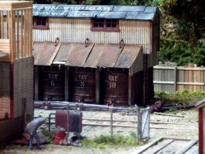

In this second photo, the corrugated metal is on the roof of the tank shed. Again it was dunked in Etchant for several seconds. I then dunked it in a container of water and baking soda to stop the chemical reaction.

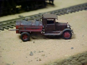

Here's W. E. Stench and Sons Rendering Company's pump truck after a liberal dose of Rust All....did nothing for the smell though!!:D :D

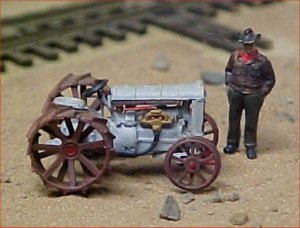

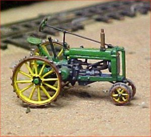

And just for Casey....Here's old Ezra's JD 4!!! Keeps it clean don't he?:D :D :D Just a little Rust-All on the wheels!:)

And here's the Robber Barron "hisseff" with his restored Fordson:D Again nothing but Rust All on the wheels.:)

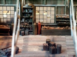

Drew, yes I stain all of my boards ahead of time. It's one of the first things I do before beginning construction. (I have always been a firm believer in painting and staining before gluing.)
The method I use for staining strip wood is always the same. The "recipe" I use, however, varies depending on what final coloring/shading I want the wood to take on. To get the color you see on the exterior boards of the tractor repair shed, I used the following:
Approx 20 oz. water
1 tsp. India ink
1-1/2 tsps. acrylic burnt umber (Folk Art, Plaid, Apple Barrel, Ceramcoat - all available from Walmart - are great for this!)
1/2 to 1 tsp. acrylic burnt sienna
Mix well (I use an old pickle jar). Put the stripwood in a ziplock bag and pour the stain in the bag. Leave the stripwood in the stain for up to 24 hours, but be sure to turn the bag over every 4 hours or so because the pigments will settle to the bottom otherwise. Remove the stripwood after several hours and spread out on paper towels or newpaper and allow to dry thoroughly. The color of the wood should be varied from one piece to another but overall have the gray-brown color of old wood.
To get the reddish color you see in the flooring in the photo below, I used the following "recipe:"
Approx 20 oz. water
1 tsp. India ink
2 tsps. acrylic burnt sienna
1/2 to 3/4 tsp. acrylic burnt umber
I admit it's "fussier" and more time consuming than using simple washes of India ink/alcohol, but I think the end results are more realistic when trying to model certain types of wood (old white or red oak, for example).
Brett Gallant at Sierra West recommends a similar method for staining woods, but his recipes typically call for more paint colors (usually blacks as well as Roof Brown, RR Tie brown, etc.), and he prefers the Polly line of paints. I have been using my method for years and it works well for me, so I have stayed with it.
Hope this helps. And BTW: I don't recommend it for scribed siding because of warpage. If you have lots of time and heavy weights (like bricks) to weigh the siding down after staining, it's OK... most of the time.:rolleyes:

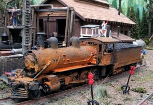

Shamus you need to get on those little plastic people fer not doin the maintenance! Those locos are far to expensive to let rust like that!:D :D :D
