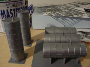

I need some ideas
I need some ideas on how to weather these guys. If these are used for gasoline, would they have rust? The only one I have ever seen in real life is about 2 or 3 hours away and I don't know if it still there after quite a few years. Thanks.

Nice work on that kit RaiderCTE!!
:cool: :cool: (looks like a cool layout too)
That's a great kit!
I incorporated part of the N scale version into my chemical plant.
