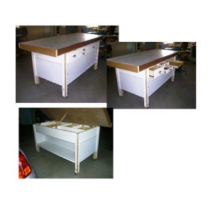

Well, I've been a bit hesitant to post any pictures of my progress since I'm kinda just plodding along and not sure of what I'm doing. Thanks to all you out there, I've at least got a fighting chance, but I am open to any criticism that will help me keep from really going astray.:eek:
To start with, I put togeether this bench from a 34" x 80" hollow core door. I recently had knee surgery and I cannot crawl underneith to do my wiring, so I hinged the door so I could get to the wiring while standing. Since I had all that room below I added three drawers for tools and parts and a slide-out shelf for my power packs and control panel. There are sliding doors for storage in the front and open storage in the back. I put casters on the legs (thanks for the idea Charlie) and made them adjustable for unlevel floors. The casters have been a blessing, the adjustable legs, well, they need some more engineering.:rolleyes:

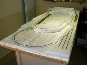

Step 2
I drew my track layout full size and traced it onto the foam and just started cutting and gluing. I found this not to be as scary as I thought since it is very forgiving. Cut to much, hey, no problem, glue back a piece and trim it to fit. I moved a couple of the inclines when I didn't think they would work out where I had them.

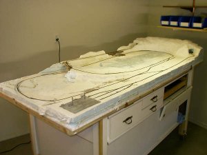

Next step
I did some shaping and plastering to give me a surface to attach my roadbed and used black tape to trace out my track.

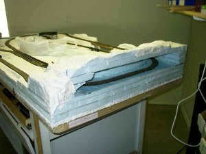

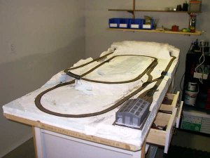

Roadbed at last
This is where I am right now. I've got the roadbed down and am starting to lay track. Based on the advice I got here, I am going to make sure I can run trains before I start to add any details to the terrain. I did a sketch of my layout in CAD so now I can use it for figuring out my wiring and where I want to put things.
I got a long way to go, but I hope what I've done so far is got me heading in the right direction. I am open for comments so please don't try to spare my feelings if you think I'm all screwed up and should take up knitting or some other hobby. :rolleyes:

Your layout is looking great! 'Course, progress is destined to grind to a halt once you get trains running. It does take many, many hours of testing to ensure the trackwork is okay. Trains have to go 'round, and 'round, and 'round.................

Hi EZ, thats one hell of a nice way to have a small railroad, like the idea of draws underneath for storage.

EZ, a great concept and wonderful bechwork wiring solution. I like the built in storage and hinged top. The track plan looks good with a long run and a couple of switching oportunities. Just one question...
Um... How are you going to lay track in that tunnel?

That hinged top is a real stroke of genius! :cool:
And that cabinet work is truly some master craftsmanship!
