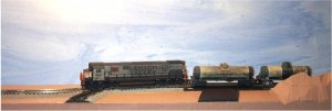

white foam bad - make big mess and not cut very well.
hills are fairly easy though. best bet is to use plaster cloth overtop of some type of simple frame (cardboard, chicken wire, etc.), *or* **BLUE** styrofoam (i think the pink stuff is about the same). comes in various thicknesses, glues together really well, and pow, you can cut it nice and easy and comes out very clean.
The hill on the right of this pic is done using blue styrofoam, and a hot wire cutter, then painted. Still have to do some more work on it, but you get the idea. I **KNOW** others have much better pics I'm sure they'll be happy to share, or point you to.....

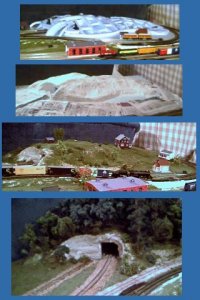

When I built my old layout, I meant for it to be totally flat. But after a short while I decided that I needed a scenery break. I used some spare pieces of blue foam to make a framework, which I then covered in plaster cloth. (Actually, it was 90% plaster cloth and 10% newspaper dipped in plaster. I thought I had enough plaster cloth left over from another project...well, you get the idea.) Then I painted the plaster and sprinkled on the ground foam. Later, I drilled and poked holes in it and put in some trees.
