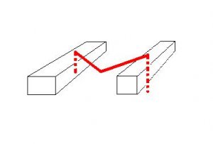

You can also make a spring from thin gauge "piano" (i.e. stiff) wire. With a few bends you get a spring that holds the points to either side. Sort of a do-it-yourself Peco. Using balck wire hides the spring reasonably well. Some of the guys at the modular club use them, and they work well.
Basically, you want to anchor the spring with a leg in a tie near the throw bar. Then you want a 90 degree bend at 45 degrees to the track, with the other leg in the throw bar itself. THe idea is that the 90 degree bend will force the points to either side, but not allow them to "float" in between. I hope the diagram helps - it's a tricky thing to explain, but is really very simple. The red line is the spring - it is dashed where it goes straight down into the ties.

thanks for the diagram on the homemade spring.
that is a good idea, my problem is that with atlas
code 80 turnouts, the hole in the tie that moves
the point rails is on the side and if i drill in the center
of that tie to create a hole, i will hit parts of the point rail
that (i assume) makes it insulated. i guess i could run an
experiment and see what happens.

No problem. As for the hole in the throw bar (the tie that moves), as long as you do not connect one side to the other electrically (thereby causing a short) you should be ok. But experimentation is fun...! Be sure to get a picture or two to show us...
