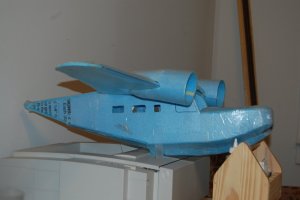

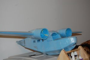

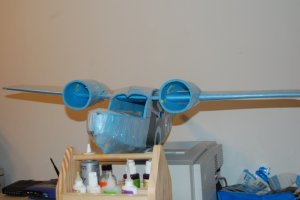

I have been doing these conversions for close to 8 years now.. I started with a 32 inch wingspan Fiddlers Green P-51 .. remarkably she flew and rather well .. so over the years i have done over 50 conversions .. Here is the mid point of my latest attempt .. a Fiddlers Green Grumman Goose ... 1/4 inch Bluecor insulation foam (From Lowes) .. I copied and enlarged the plans in Adobe illustrator and printed them out on my Plotter printer ..
The hardest thing about converting them to 1/4 inch foam is accounting for the thickness of the foam when doing formers and where 2 pieces join together .. like fuselage sides joining the hull and top ..
I will post more here as i make progress if there is interest .. I had more photos but my other computer is down with a bad power supply ..
Pics are Below ..

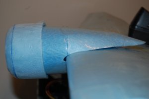

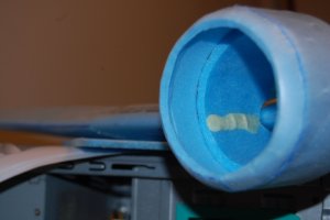

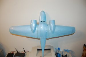

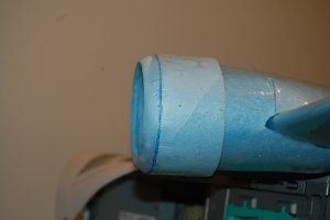

A little progress this evening Got the cowlings cut and put together .. next a little sanding to get the nice round edges and they will be ready to cover .. i may do silkspan and resin to strengthen her up and also makes for a nice paintable surface ..
