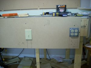

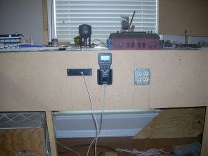

I used 1/8 inch tempered masonite for mine. added blocking behind it for switchs and outlets
