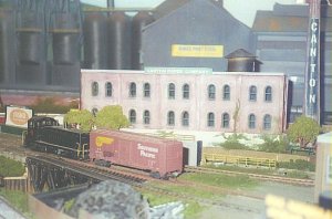

That's great Kyle! Sometimes regular objects around the home nicely fit the bill for representing railroad/industrial things. Looking forward to seeing what you do with them! I thought I'd post a pic of the Walthers smokestack Ed mentioned.

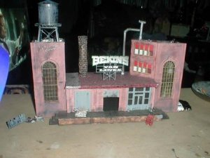

Hi Crew,
I'm resurrecting this thread 'cuz I finally got a new camera! YEAH!
Here are my smokestacks... better late than never.
