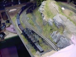

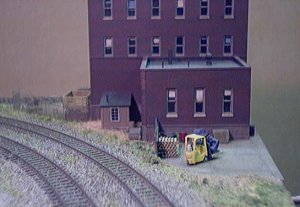

It worked.:) Welcome to The Gauge. Great pic, post some more if you would, I'm sure we'd all love to see them.
Don
MagicMan_841
This has to be one of the nicest layouts I have seen. Sure, those basement empires are nice, but Chris' layout is small, simple, operable, well scenicked.
Good job, sir
Blake
Welcome to the gauge Chris333. I myself am an Erie N scaler. Love your layout! Did I see a Model Power reefer converted into an Erie milk car? When will we get some Berkshires!? Check out my site, I do custom painting and have a gang of Erie stuff there.

Everyone thanks for the comments. If you go to the link you can see more pics. I will try to post more of them, but some are large.

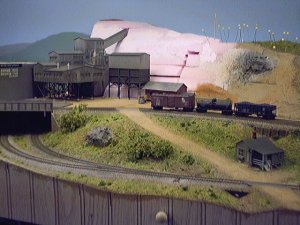

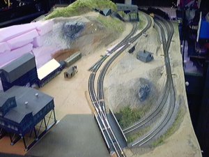

By the way I thought I would explain the layout. It is feelanced, but based on the Eries bradford branch where it connected with the Pittsburg & Shawmut and the coal fields. The track is all code 55, flex is ME that was laying around, turnouts are atlas #5s. The size of the layout is 2'3" X 4' and is all foam except for some 1x2s around the edge. I panned the whole layout full size on a scrap of cardboard and had all the structures and bridges built before anything else ( I was waiting for the new atlas code55 to show up ) The track to the coal tipple is alll laid now, but I have a lot more scenery to finish.

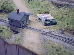

A company house, thought I would post this one because of all the heavy flooding here in Ohio the last week ! lol

Welcome to the Gauge Chris333, Thanks for the pics thats a nice layout you built.

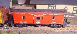

Great stuff. I have the older Berk and did the same thing. The boiler is clean. Added weight but the drive is very sloppy and the electrical pick-up is the pits. About every 3 months or so, I pick it up, mess with it and put it back. One of these days. As far as cabeese go, I kitbashed a wooden one out of a Micro-trains car. It was more trouble than it was worth. Looks nice, but it was easier to scratchbuild. I also built 2 bay window cabooses. One with 4 windows per side (C-300 as built, no lightning bolts) and one other one. I measured the lightning bolts on a set of Prime Mover HO decals, calculated it out and cut mine out of white decal stock. I found bits and pieces of the words "For Safety, For Service" and "Radio" from several sets of decal scraps from god only knows where. I have urged Paul Tupaczewski at Prime Mover to make an N scale set of these great decals. 2 of my HO cabooses are shown on the Prime Mover Website. I have also urged Paul Ellis (R&D guy for Microscale) and have even sent him a list of what he needs to do a set of Erie/Erie Lackawanna passenger car decals (including milk cars). "Yeah, that's a great idea". Have heard nothing since. I have built an HO Dunmore caboose, a Joe Lofland Models kit. I did it for a review in RMC that will be coming out in a month or so. I am also working on a "How to" kitbashing article on those PS 3 bay covered hoppers with the big ERIE lettering. Anyhow, Below is a photo of my N scale bay window hack. Talk soon and don't be a stranger. LET'S SEE SOME MORE PHOTOS!!

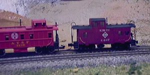

Dang, I'm jealous. Seems like your one step ahead of me ;) I'll take some pics of my baywindow when its done. I did a dunmore caboose in n scale, but the windows on the top don't look so good. We need some brass eched sides for these !!
My berk need a new motor, was thinking about trying the new atlas slow speed motor (?) I'm sure it will be a while before it hits the rails though.
What have you done for erie passenger cars? I have the concor set, but nothing prototypical yet. Some stillwells would be real nice.
Chris
Caboose before and after:
