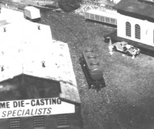

Vic is right with his warning about magnetic particles. Black sand for 'sand-arters' could contain ferrous oxide which can raise havoc with our motors.
For industry yards and the area around the engine house I used very fine grained sand, I bought in a pet shop. They called it 'Bird Sand' because it was used to cover the floor of birdcages. It is almost white in color and has many other uses in landscaping, too!
In my industrial yard I added black watercolor to the wet-water/glue mixture, then I repainted unsatisfactory spots with brown black watercolors. So I got that dirty, oil-soaked look.
When filling in the sand between the rails just be sure to completely cover the ties, but leave room enough for the wheel flanges. As the picture shows, all you finally see are the railheads.
BTW, my layout was N scale, so in H0 scale the ground structure should turn out even finer than in my pic.
Ron

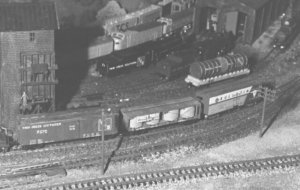

thank you for the compliment. I used to do my own developing and printing of B&W photographs waaaay back in the 1970's. I dug around in my photo archives, and here's another pic of my N scale layout - the Trim Creek Southern RR. It shows the engine terminal of Trim Creek and four of my scratchbuilt freight cars.
(For the real oldtimers among us: Does anybody remember the 'Bulletin Car', the product of an NMRA contest? I think it was in 1972 or '73, when they printed cardboard sides in the NMRA Bulletin. All you had to do :rolleyes: was to build a scratchbuilt reefer to go with these sides! :eek: :D )
And now for the running thread:
Warren,
here you see how the 'bird-sand-technique' mentioned above turned out in my engine house area - that's what you were looking for in the first place. As you see, the shading of the ground colors can be varied very well - from oil-soaked dirt to clean, sandy ground.
Ron
