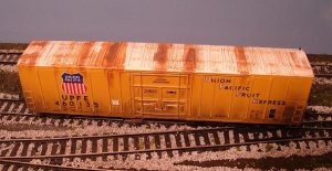

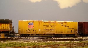

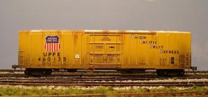

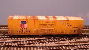

Early this morning i dusted off my airbrush and decided to make an "attempt" at doing RUST(new to me), and to weather a car "old school", just like i used to do em, with an airbrush:thumb: . IN Lew of some of the posts i have seen today, i think it was a good idea to do it this way, just to show there are MANY different ways to do(attempt:eek:ops: ) weathering;):D. the car i chose is a UP mech reefer i picked up at the show yesterday for $6.00:thumb: i used a small and medium paint brush, my airbrush, and Floquil paints. i use 3 types of paint(Floquil, Badger and Polly Scale)but for this job i decided Floquil would be best;) . colors used: engine black, rust, and boxcar red. i put a little boxcar red in the rust(so it wouldn't look to orange), and a little in the black:thumb: . **on the sides I USED THE AIRBRUSH ONLY, on the top for the rust i did SOME airbrushing, but MOSTLY dry brushing;) . **ANYWAYS, i JUST finished it, except for putting on dull cote, might want to go back into it hamr tooth1 . THANKS!:D -Deano View attachment 30179 View attachment 30180 View attachment 30181 View attachment 30182

Great, it shows more versitility in your weathering accomplishments and techniques!

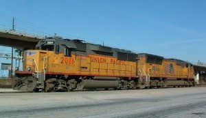

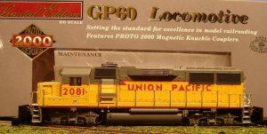

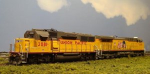

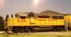

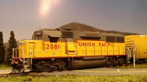

OK, i have gotten WAY off the beaten path latelytooth1, time to throw another engine into the mix:thumb: . 6 down, 47 to go:D . THIS engine i am waiting on ditch lights i ordered from Walther's for it, but other then that, i am going to call it FINISHED! to be honest with you folks, i like all the geeps up to the GP30, the GP30 is my FAVORITE of ALL the geeps:thumb:. i am NOT much a "newer" geep fan, but i tell you what, this GP60 is SLAP AWESOME!, and is my second favorite of the geeps. **its a UP GP60, the model is made by P2K, here is what i have done to it; installed an MRC Brillance sound decoder, AC unit, firecracker antenna, sunshades, plow, GPS, added 2 decals, painted the leading railings, coupler cut bars, hose couplers, rail brace above the intake, and weathered the lower half of it:thumb:. **first pic is the engine "out of thee box", second pic is the prototype, the rest of the pics are of the engine finished:thumb: . THANKS!:D -Deano View attachment 30198 View attachment 30199 View attachment 30200 View attachment 30201 View attachment 30202

Nice work, Dean. A big improvement and a real noticeable difference over the stock model. The shot of the two units together is nice, too.:thumb:

Sweet, That GP60 looks great.
O and that UP Reefer looks awsome, I just got that car off e-bay for $3.00 sign1 but it isn't in all that great of shape so I got what I payed for. And the rust looks great!!! Keep up the awsome work!!!:thumb: :D

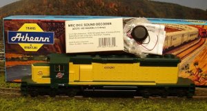

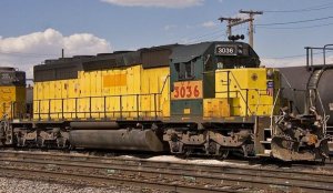

viperman, THANKS!!:D **Josh, THANK YOU! for the complements on the GP and the rust & weathering on the mech reefer:D . i seen in another thread that you too, had just got a mech reefer, i thought you'd like it;):D. **Wayne, THANK YOU!, for the VERY KIND words on the GP.:D THANKS GUYS!, your comments were GREATLY appreciated. **announce1 ON A DIFFERENT NOTE, i took a vacation day today, so i went to the LHS:thumb:. I needed to stock up on some Floquil and Badger brand colors, pick up some aircraft paint thinner, Dull cote and Solvaset. i walked in, went straight to the engine counter(as usual:D) , and seen they had a Athearn CNW SD40-2 for $35.00...well, I'm sure you see where this is goingtooth1(54 engines now) . ANYWAYS, i picked up a MRC 370AD sound decoder to go with it for $49.99. **I KNOW i have rated the MRC 370AD sound decoder as "poor" in quality, BUT STILL, it IS a sound decoder, and now i have a DCC sound engine for the low, low price of $85.00!!! HARD TO BEAT THAT!!:thumb::D....OH, BTW, on my way home i realized i had FORGOT to get Solvasetwall1 hamr. LOOKS like i will be going back to the LHS later this week tootooth1 . **FIST PIC, the engine and sound decoder, right out of the box. SECOND PIC, the proto i plan on going by to do this engine. :D -Deano View attachment 30211 View attachment 30212

OH, NOO!!! not another patch! :cry: Sniffle sniffle! However, I'm glad you're proud of me, Deano! :D
On the other hand, if you pull it off correctly, rustand all, it should make a fantasic Model!! :thumb:
UP SD40-2
On the other hand, if you pull it off correctly, rustand all, it should make a fantastic Model!! :thumb:
i know Miles, but i am modeling CURRENT UP, and the cold hard fact is, these units are out there now;) . hey, you know i AM a big CNW fan too:thumb: , in fact, i have a CNW Dash-9 that I WILL NEVER PATCH in honor of the last unpatched Dash-9's that are still running today:thumb::D. i think there is 4 left:confused: . not to mention all my transition era CNW units. AND yes, i am going to do the unit, rust and all:thumb: :D . :D -Deano
viperman
You have to post a pic of one of those Deano, I think I saw one last weekend.
