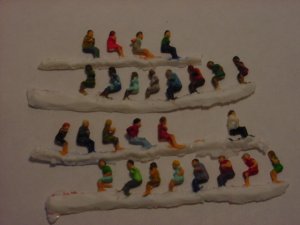

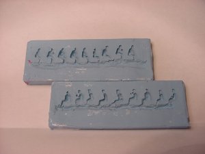

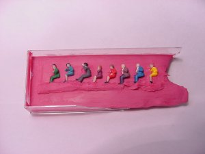

Think I have too much time on my hands - started making little people for my Santa Fe Valley Line passenger cars. Bought a pack of sitting people and thought I would try and duplicate a few, ya like - maybe a couple of hundred. Only have to mold half people as this is all that is visable through the window of the car. The picture is how I made the mold of my half people. It's a mess because I had just broken the side of the box to remove the rubber mold. Think you will get the idea of how I did it, lined the bottom of a plastic box with modeling clay and pushed the people in half way. Made a mold for 1/2 people left and right sides. Made a clay sprue, not for pouring the plastic but rather for a way to hold the little suckers for painting. Covered the molding material I used in a previous post. (Micro Mark RTV and 10 minute cure plastic.)

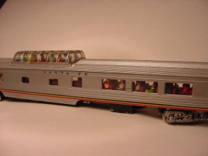

Wait for the glue to dry and put the car top back on, whalla! one full loaded passenger car. Only eight more cars to go.

By golly Bill I'm retired and don't have that much time on my hands. I will say you done one fine job as they look just beautiful in there little seats. Great job. Ron :D :D ;)

Due to lack of $$$$$ I bought a pack (125) unpainted n-scale figures and have painted a few. Makes me really appreciate the effort to paint half figures, must less mold em' too! :eek: :D

Wow Bill, you are showing a great HOW TO here. Thanks for showing us your method. Those passenger cars look like they are earning revenue for your railroad.

I had to look twice to make sure they weren't HO scale or larger :) . I'm impressed that they show up so well in the coach.
