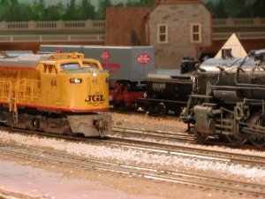

To make clearer the era being modeled, JGL turbine is shown meeting the Erie Berk. JGL had the turbines well before the UP, by the way.

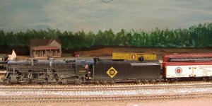

Notice in the background of the previous photo the NYC tofc car, obviously early 1950's! Notice also unpainted rail, I wasn't aware I hadn't painted that area yet! God I hate that. Oh well. If only that was my biggest problem! But as this photo shows, I have one other potential problem solved, when nitpickers try to tell me some unit is too recent for my period, I just show them the JGL logo!
