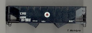

Ok I took a deep breath and gave it a try.
I think it came out well. The set was from CDS and for a LNE 2-Bay Offset Hopper. I had to do very little lining up as the different sections such as recording marks were together. The hearld however had to be done in three steps; first the red dot, then the white crcle then the lettering.
I don't like the matte sealer I used on the car. I think it came out to glossy. Well after I finish assembling the car I will have to weather it any way.
BTW it started out as a undecorated Atheran 34' Offset hopper.

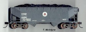

I just got around to finishing the LNE hopper. I weathered it and added a home made coal load. So here is the finished product of my dry transfer experiment.
