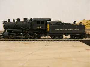

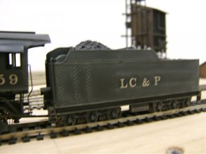

Hi...Dr...Do you have the name you're transfering already made up..? Or do you do a letter at a time..? I tried this a few times..But it's hard to get the individual letters to line up correctly...

Gus, all of the examples shown in the photos, above, were done with alphabet sets. A useful trick for keeping things straight (and I don't always keep things straight :eek:ops: ) is to place a strip of masking tape above or below where you want to place the lettering. Place the strip of tape on a sheet of glass, keeping the strip straight - use the edge of the glass, if it's straight, as a reference, or use a ruler. Masking tape is made so that it can be curved somewhat, so you have to ensure that the piece that you're using is straight and true. Use a sharp blade to remove the edge that you plan on using as the reference on the model, making sure to make your cut parallel to the existing edge. This trimming removes nicks and dents that mar the edges of the tape while it's still on the roll.
Now, using dividers, or calipers, if you have them, or a ruler if not, position the tape on your model so that the reference (straight) edge of the tape is parallel to a suitable edge on the model, such as the bottom edge of the body casting, or a line of rivets. You'll not likely be able to place the letters directly against the cut edge of the tape, but if you cut out the letters from the sheet with the same-width margin to be placed against the tape edge, your letters should end up pretty straight. I often don't bother to cut the letters from the sheet: with the tape edge close to the area where I'm placing the letters, it's pretty easy to line them up "by eye".
You can use this for decals, too, though your margins that butt-up against the tape should be cut fairly small and accurate.
For lettering passenger cars with dry transfers, I use a piece of masking tape with the places for the ends of the individual words denoted, along with notations concerning how the tape should be positioned with reference to details on the car's side. The same strip of tape can be re-used several times. I've probably done around 60 or 70 passenger cars in this roadname, using dry transfer alphabet sets. In most cases, the width of the letterboard or the proximity of the roof's eave is enough to keep things reasonably straight.
The car in the last photo used the dry transfers as masks, so all of the lettering is actually painted.
