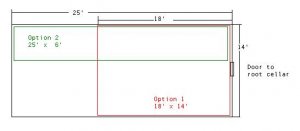

Tim K said:
Good descriptions for a cold cellar :) .
I can't post any pics but the area is a very simple 14X18 with the door along the one wall for the cold cellar.Two wall are 18 and the door wall is 14 .
I cant move it away from that wall because the other area of the basement is out of bounds.
Tim
Tim,
Even a crude drawing in MS Paint with the dimensions indicated would be helpful...
Does it look anything like this...?
Andrew

Tim K
Dec 30, 2005
100
59
Stoney Creek On. Canada
That is prety much it Andrew
I spent a little time masking out both ideas I have and decided pretty quickly
that the around the room layout was not only more appealling visually but it
also gave me a lot more room for my boats.
Plus my wife agreed that if I wanted to expand in the future I could still use the other area that I was thinking about.
Thanks guy's again for all your help
