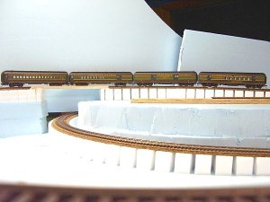

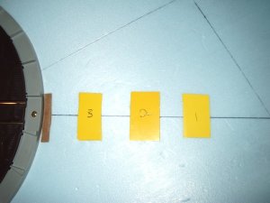

David, I will definitely use the brass tube. It's nice to know I'm in good company! Galen, I checked Walthers yesterday and didn't see 60 footers (I must be blind). I followed your link and ordered the NP set...looks beautiful. I'm glad you enjoy seeing your plan come to life because I'm having a blast doing it! Posting one picture today: the roadbed was a little lower than the edge of the turn table so I had to improvise. the numbers in the cardboard indicate how many are glued together to create an incline. I don't know if it was necessary, but I wanted to play it safe.
Talk to you all soon. P.S. Galen, any pics of your work?

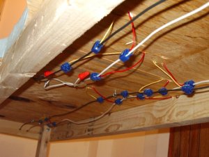

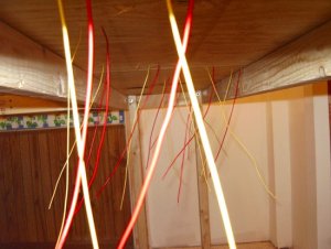

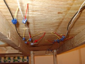

I've been doing the wiring and believe me, its an adventure. Its so easy to mess up! I'll just pass along 2 useful pieces of advice for fellow rookies: 1. Keep your wire color coded. I bought black and white 14GA for the main buses ( it was on clearance) and for the feeders I found 20GA wire in red and yellow (again, dirt cheap). Well it was a pain in the begining until I got used to which wires went together, which brings me to: 2. Do yourself a huge favor and assemble the Buzzer device recommended on the invaluable "wiring for dcc" website. It immediately alerts you to any short as you wire it. Believe me, IT WORKS! I messed up about 4 or 5 times and it saved me before I moved on. On another subject, you are going to see that I didn't solder my feeds to the bus ( I used "insulation displacement connectors"), that's just a fancy way of saying that they "bite" though the insulation and into the wire. Its a real time saver although the purists will say ( and rightly so ) that soldering is more reliable. These connectors have been used with great effect industrially for years...we shall see, I just wanted to try it........Still waiting for my Zephyr...I'll be talking to you

Looks good. I wouldn't worry too much about the "suitcase" connecters. They typically only fail when they corrode or are exposed to extreme vibration if the are installed properly to start. I would think about shooting a bit of RTV into each end as a precaution.

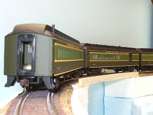

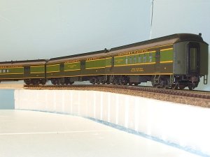

Kurgan, Thank you for the encouragement and I'm glad you ordered the engines, that should get those juices flowing! David, I'm half Scot myself, but the other half won! Galen, I checked out both sites, what an undertaking with the 0-4-0! Awsome! I know what you mean about Kids and time. I can't imagine doing this even 2 years ago. But you're right, They're totally worth it! Now, what trains am I going to run? Good question. To be totally honest, I've been so busy trying to get the layout going that I haven't thought too much about It until the last week or so. You know I bought the 60' passenger cars (they arrived today) and I ordered a Proto 2000 heritage USRA 0-8-0. I figured that was as big as I would want to go on the 18" curves. A Proto 2000 0-6-0 is comming out in May so I may get that. I want a shay for the coal run. So... I want to run a passenger train, a freight train, the shay, and have a switcher for the Yard. As far as era, I want to keep it in the first half of the 20th century, But I don't plan on fretting over every detail. If I like something and it looks good but isn't prototypical, I'll use it. That's as far as I've thought about it. Anybody want to chime in, you're welcome to. I'd like to hear any ideas for ops or locos or whatever. Here's some pics of the new cars...........still waiting for the Zephyr....come on Tony.....please.....

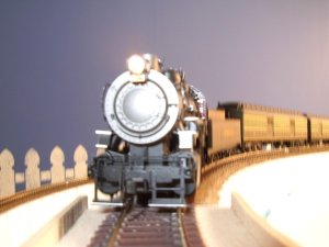

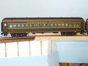

HOORAY!!!My Zephyr arrived todayballoon6But my reversing units didn't!:cry:NO MATTER, I set up the digitrax and ran my loco on the areas that aren't part of the reversing loop. SWEEEEEEEEETTTT!!! The proto 2k 0-8-0 runs like a top. I had a derailment problem on 1 turnout (a little filing) and so far so good:thumb: . I coupled the passenger cars and it pulled the 4 of them nicely up the 3% grades. I'll know more when I install the auto reverse units and I can check out the rest of the track. On another note I found a Campbell's Idaho Springs mine and ordered it (tough to find for obvious reasons). Looking forward to trying my hand at it. Gotta go and run some T R A I N S!!! :D :D
