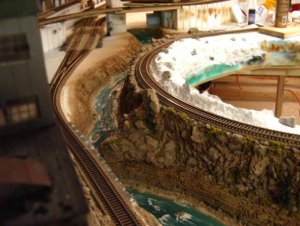

Don't laugh too hard...It's my first attempt!

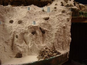

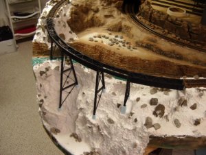

I use white glue to hold the rocks (on fairly flat surfaces) and hot glue on slopes. most of the time I glue them right to the foam or plaster. I also add them on top of sculptamold (SM) if I want more texture and or some realistic rock forms. I then blend them in with SM so they look embedded in the landscape (unless I want it to look like a recent "slide" or a few scattered rocks here and there).
This pic shows rocks attached directly to the plaster and some attached to SM.....That hot glue really holds!
Here it is after adding the SM...It will look better after it is painted....(I HOPE)

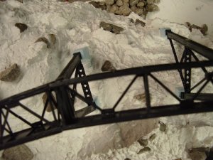

I will not be putting any SM around the pile at the bottom because I want it to look loose. I glued them together one at a time but I guess I could have made the pile and sprayed it with scenic cement or the ol' 50/50 mix of white glue/water (but that would be too smart!):D
As an update: I am just about finished with the Sculptamold and then it will need a few days to thoroughly dry...then I can paint the rocks and the bridge and start the install. I'm hoping to get this section back up and running for the one year anniversary of this thread near the end of January...........yeah right!sign1

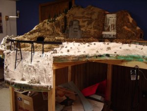

I have FINALLY FINISHED ALL of the sculptamold....I think I now have about 18+ hrs on this section (could be more). I am going to try and paint the viaduct tomorrow while the SM dries

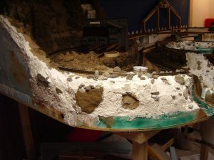

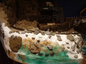

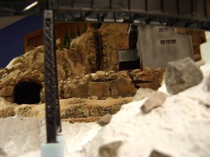

Here's a few "fun" Pics (that means I had fun taking them;)):
Lookin' thru to the mine
Bungee anyone?
If you look to the left (****EDIT****I meant right), you'll see one of my Christmas presents hanging on the bench work....yeah baby!
