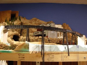

Don't laugh too hard...It's my first attempt!

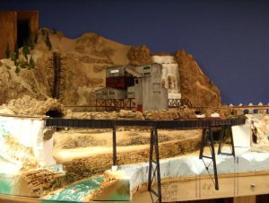

Galen...you want more pictures, sure!..nobody has to twist my arm! I love showing gratuitous pictures of my work! (I feel so cheap)sign1
First up: I used some "L" brackets I had laying around to support the bottom of the ravine

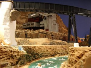

Next are all of those tacky self-promotional photos I was telling you about.:rolleyes: I almost feel bad doing it......almost:D
viperman
Steve, I look forward to more progress on this scene. I like ho you dropped the level in the corner like that, I bet it will be awesome lookin soon enough (given you have time to work on it). Keep us posted
I do like those other pictures you took there, they do really make the scene all that much better, especially with that bridge

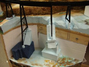

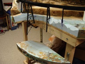

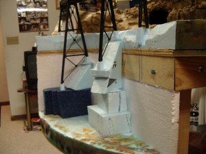

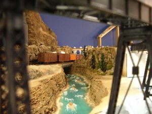

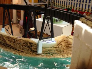

OK...so here's what I got done tonight: I enclosed the lower area and added some rough slopes under the towers...I also made some "cement" footing shapes out of blue foam. I'm really just trying to determine heights and get a feel of what looks right. I'm happy so far with the look but that may change.
Here's some pics:
UP SD40-2
SLAP AWESOME STEVE!!!:thumb: :thumb: :thumb: i think this section of the layout will be the SHOWCASE of it!:D well, perhaps not, knowing you, you'll some how top this FANTASTIC IDEA!;):D. cant wait to see more pics! :D -Deano
Herc Driver
That's going to be awesome! You're going to get some stellar pictures when that's all done and it's going to look great. Really nice work.

Heck...just paint the footings black, then drybrush on progressively lighter shades of gray and tan until it resembles concrete, then finish with some splotchy moss around the bases (WS fine ground foam mixed with matte medium stippled on with a stiff bristled brush) and you're done! Conceal a brass rod or suitable support inside for structural stability if you wish...depends on how heavy the trains are and how stable the bridge is overall.
*and yes, I did plan the curve for just such a 'beauty shot' since it's perhaps the first thing folks will see in the room, but I don't think of EVERYTHING! Otherwise I'd have made it a slightly larger radius to ease your curved bridge frustrations! But it's really turning out great. Thanks again for sharing!

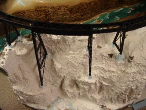

Introducing Burt the Engineer
Hi all
I've decided to post the progress pics in two batches. This is the first, the second will be finished pics after painting. I have used no new techniques here so I'm not going into great depth (unless feed-back dictates otherwise).
I really don't have time to go through it all so I've asked a good friend of mine: Burt the Engineer to describe what your seeing in the pics. I know Burt seems a bit gruff at first but he's really "an old softy".........once you get to know him.........no really, he is...........

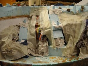

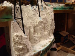

Next he's added the Sculptamold. All work was shaped with a putty knife (how easy is that). Use photos to help you decide on shapes and texture...keep it interesting.....unlike Steve
Thanks Burtram....I think....... (he hates it when you don't call him Burt the engineer):D
