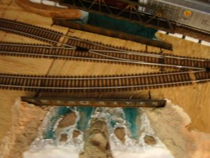

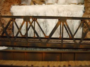

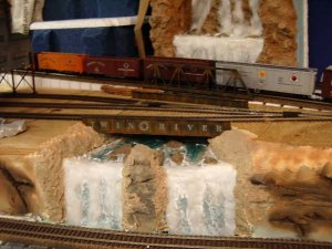

First try at weathering
Hey guys,
I had an Atlas thru girder bridge and I figured I'd experiment with it. I cut the sides off and they were a perfect fit for the bridge to the mine. I painted it and the truss bridge a very dark gray and then tried my hand (and airbrush) at some weathering. In this case, RUST! And lots of it. Those guys better break out the paint pretty soon or there's going to be a PROBLEM! Thats what you get for putting steel bridges that close to waterfalls! sign1

The weathering looks great those bridges look great in front of that nice waterfall:wave: . I have a brand new passhe airbrush in the box but I'm too scared to use it :eek:ops: Just curious what kinda paints do you use?

Those "experimental" bridges came out looking great! If that was something you just threw together and painted, I'd hate to see what you could do if you really put your mind to it.
I really like the bridge with the turnouts over it; I have a few spots like that on my layout.

Thank you Lynn and Chris
Lynn I use the cheapest craft store paints I can find. For the rust color I mixed yellow ochre and burnt sienna. I used the airbrush for most of it and a toothpick dipped in the paint for the streaks and joint work.
Chris, A bridge at that point wasn't in the original plan but I wanted a little longer mine area so I pushed the river to the right. I honestly didn't know what else to do for a bridge there...I believe I saw a picture somewhere of a layout that used girders around multiple turnouts. When it's ballasted it should look better. I took a pic looking down so it's easier to see the set up (and the "cheating" I did)....shhhhhhh...don't tell anyone!

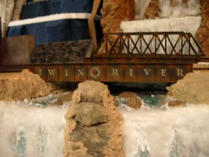

I also decided to add lettering so it could be a focal point with the name of the Layout.

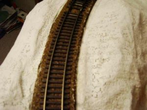

Chris
I'm going to ballast all my track including on the risers and inclines... just going to do it last. I used roadbed everywhere I put track. As for you...It depends on the look you want. If it's a well traveled section of track (mainline ect.) you'll want to use roadbed for the raised, well maintained look. The only places you don't need it are for lightly used spurs and sidings (that's probably an over simplification). You have to cover the top of the risers and inclines anyway....why not with roadbed? If you decide later that you want a flatter look, you can build the surrounding terrain to the elevation of the roadbed. G.E.C.'s recommendations are, of course, right on the money.
PIC
There's a riser somewhere under there just waitin' for ballast!tooth1

Steve:
Aaah; the blind man can now see. I see that you put plaster cloth over the risers. I am putting the roadbed over my risers as well; just wondering how to fill in the holes.

Chris,
In tight or narrow places I've been putting masking tape to cover the holes and troweling a little Sculptamold or P.O.P on top.
