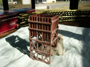

One of my current projects is a long abandoned coaling station. I model diesel (mostly 70's to modern) and I wanted this structure to look like it hasn't been used since the 50's.
I started with this Bachmann coaling station I picked up at the LHS.
I then stripped the roof off it and weathered it appropriately.
Next I rubbed aluminum foil into the contours of the original roof and spray painted it a rust color.
The next step was to cut and place rafters where the original roof had been.
I weathered the rafters with a wash of gray paint and alcohol.
The next step was to cut the roofing into scale 4x10 foot pieces.
I then used white glue and a pair of tweezers to place the sheets where I wanted them. I used the tweezers to tease the bends into them. First one side:
Then the other side:

Hi Jeff: I like your "bashing" efforts much better than the shiny plastic of the, as delivered, model. That must have been some wind storm that peeled the roof back. Now we need a on site picture with weeds, brush and pigeon droppings.

Thanks for the suggestions. You may have noticed there's no coal chute, no loading equipment, no steps or walkways anywhere to be seen. Even the window moutons (inner frames that hold the panes in place) have been removed. This is all to give it that look that it hasn't been used for a very long time. Somebody had to have a really throwing arm to hit that window way up there. Even graffiti artists need a way to get to their target and with no steps anywhere that's a mighty tall order.

Nice work, Jeffrey! I may have to pull out mine and work on it a bit more. I got mine in a lot from ebay along with other plasticville structures. It will become a tipple for a mine up in the hills...someday.
In this shot it's just been distressed and hacked up, er, modified. The back legs are shortened and the top sections have been removed. Hopefully after painting the wood grain and distressing will show nicely.
Great idea using the original panels as a template for foil. You may have given me the solution to a challenge I had with my tipple. My approach originally was to thin the bottom edge of the roof (a la Art Curren) and that looks okay, but adding a layer of foil panels above would carry the illusion further and add to the realism. Nice. Thanks again.
