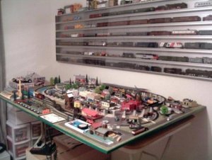

I have the Showcase Express >>> www.showcase-express.com ones, which are extruded aluminum with plastic end caps and Lexan covers. They're 4 feet long, 3" high and gauged for HO equipment down the center and look really clean. I bought mine used for $5 a tube at a local flea market.

You have a very nice display area. Do you routintely remove trains from the display so you can operate them? Or, do you leave the display trains alone and have a separate operational set of trains?
shaygetz
Thanks. They are all regularly operated, either on the club layout or at Christmas around my tree. As you can see, my operating layout is N scale, my model work is HO, my prefered scale. I have a series of tote trays (seen under the layout with a power pack on top) that I have built to carry them to the club house and to shows.

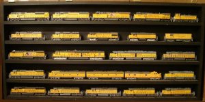

jevoltin, i home made this display case for $54.00:thumb: . that includes the wood, paint, 4 hinges and a piece of clear lexon. its 50''x24'' and has four rows with 4'' spacing, and one row with 3.5'' spacing;) . took about 3 hours to make, start to finish:thumb: .:D -Deano View attachment 29739

That is a very nice display case, especially for $54 and 3 hours invested. I was a bit concerned about the cost once I got into building my own, but maybe it won't be too high. Did you use pine or some other type of inexpensive wood? Most of the pine available locally has not been properly dried, so it tends to never remain straight.
viperman
Deano, what track do have all the engines resting on in the case? I like the idea of building a case for my stuff too, and like the way yours looks
UP SD40-2
THANKS!, John and viperman:D . i built the case a little over a year ago, i was lucky to find good quality pine on sale. it was already sanded and dry:D . i did NOT use track in it, makes it easier to put the engines in & out:thumb: . the shelves are 3.5'' wide, so the engines are not going to just fall out, besides, i have a piece of clear lexon hinged at the top that folds down over the front for extra protection:thumb: . if i were storing cars in the case(but i don't) , they roll easy, so i WOULD suggest putting track in it.;) :D -Deano
viperman
In the pic you posted, it just looked to me like there is track on the shelves. I know I would use track on each shelf, just to be safe, especially since I would be putting my MR 65th car in it too
