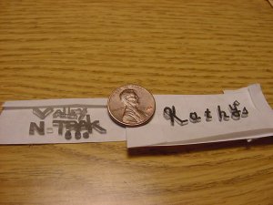

Was looking for a way to make scale letters to make my own billboards. (Basically like the laser cut type sold by Bar Mills.) A childs play activity called "Shrinky Dinks" was the answer. Didn't know the stuff still existed, found a refill package of 8 sheets in a craft store. The item, for those not familiar with it, is a thin plastic sheet you can trace and draw onto. It can be cut easily with a pair of scissors to make shapes. The artwork is then put into an oven at 350 degrees and "walla" right before your eyes it shrinks to about 60% of its original size. Because it gets thicker and very hard you can make neat individual letters. I also found that the sheet will go through my older HP deskjet printer, grayscale only, so I did not have to trace the letters. Here is a couple of first two tries

Thanks Mike, at the rate I'm going that will be many moons down the road. (See my 1x3 foot town postin and you will understand) I made a mistake describing the shrink size, it shrinks about 60%, or a little more than half its size. Nothing on the package and I did not think to get an exact measurement before and after.

Hey fellows, you are aware that the thickness increases 60%. I just took a dial caliper and measured before and after. The plastic film is .010" thick and expands on shrink to .065". This works out great for the signs I am making. Havn't tried it, but someone in my club suggested I try and illuminate each letter with fiber optics, it should work since it is clear plastic.
