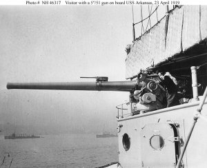

I ran into my first real bump in the road today. I began building two of the 5"-51 casemate guns and things were going well until the barrel. I rolled the first gun barrel and placed it on the mount. Something didn't look right. The taper was way too exaggerated. The breach end was way too big. Once I placed the barrel on the mount and put it in its spot on the deck, I found that the overall profile was way too tall due to the larger breach end. :eek:
When I rolled the barrel, I rolled it to the seam line printed on the paper. I doesn't appear that this is right. I don't know if this is a scale up issue, or a printing issue, but the barrel needs to be rolled a good bit tighter than the seam line to get the correct barrel diameter. The barrel needs to rest further down in the mount to get the correct overall height.
So, I have a beautiful picture of a 5"-51 mount with barrel, but it's a beta build at this point. I'll have to go back and redo this one. The second one I'm working on will end up being a test build as well, to get the correct barrel diameter. Future DN ARIZONA builders need to take note of this, as it could be an issue at regular scale as well.

5"/51 Deck Guns Perfected
Thanks for the kind comments guys...
Bob and CJTK1701... Thanks, it sure is a monster. It can be overwhelming at times.
SgtSki in MI... The DN Arizona is a good model once you feel comfortable with your skills. The fit up is great, and I've only found a couple of quirks to this point. These 5" deck guns for instance... Ignore the seam line on the barrel part. You have to roll it to a diameter based on the mount size.
Well, that took a little patience, but I've got the deck gun issue resolved. I went to the good ole Hobby Lobby and purchased some 3/32" diameter brass tube. I've used this in the past to make primary guns on smaller scale ships. This approach worked great for the 5" guns. The tube essentially becomes a former for rolling the barrel, and then I let it taper out towards the breach. The end result gives you a nice rifled muzzle for extra realism. The only down side is the added weight to the assembly. I like to use aluminum tube for this trick, but they were fresh out of 3/32" in aluminum. :curse:
These gun assemblies are quite involved even at this large scale, so I'm going to be busy building these for a few days. Two down, mid-way into two more and six to go.
Here is a side-by-side shot of my first two 5" deck guns. Top one is correct diameter and the lower one is rolled based on the seam.
I went back and fixed the first one and have mounted the pair on the shelter deck. Looking similar and fierce. :thumb:
