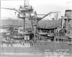

At the bottom of this entry, I've made my last shot of the boat cranes. I added a lot of detail from the last shots. I added a single-line handrail that runs up the boom and added the cables/block-hooks. I found a nice shot of the Pennsylvania (sister ship to the Arizona) that really shows these fine boom details that need to be scratch built to render accurately. You can see the two photos side-by-side for comparison.

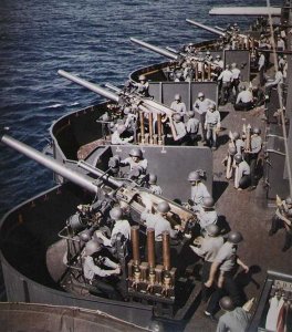

In the meantime an update. I've almost finished the other two 5"/25s on the starboard side. Quite a lot goes into them with the seats, hand wheels etc. They're fun but complex to build. Each gun has about 25-30 parts.
I've attached a good photo of what these guns look like in the flesh. The attached photos is from USS New Mexico.
