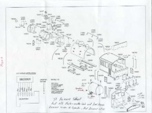

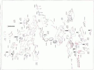

sound in 0-6-0t
This is how I'm planning to put sound in my 0-6-0t as soon as I can buy the decoder. Someone please look this over and tell me if you think that this idea will work Thanks. also note that the 1/4" depth of the notch might be too much.
