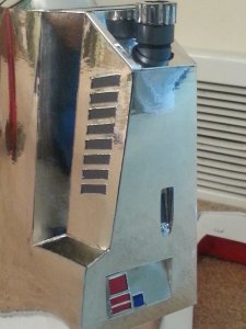

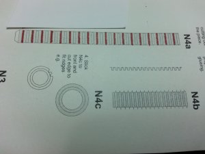

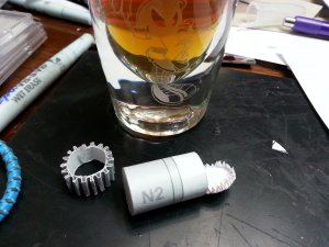

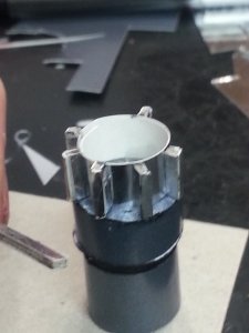

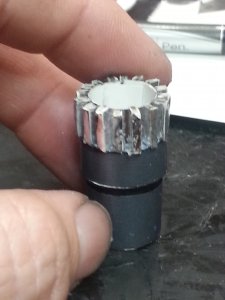

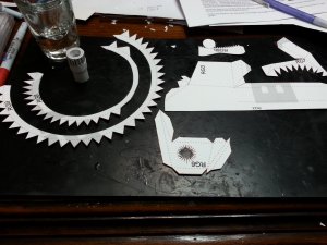

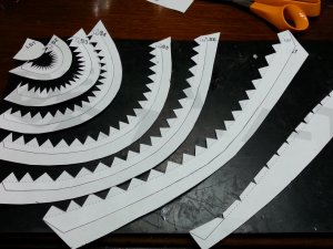

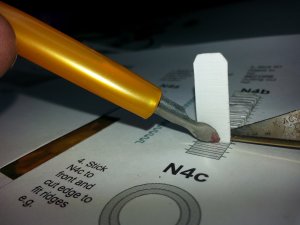

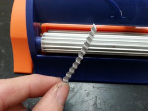

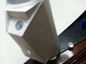

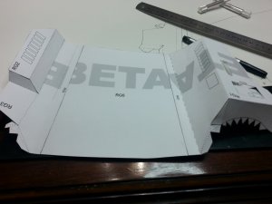

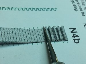

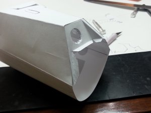

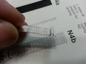

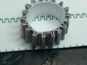

Started work on the right Guantlet and I started with the toughest part first the nozzel.

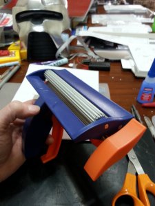

I first tried without scorring the part but the folds where too tight and too small for my fingers alone, then I tried this tool I found at Hobby Lobby but the bends where rounded, so this did not work.

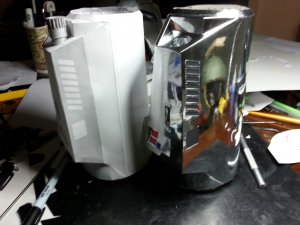

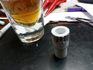

Then I went back and scorred the part front and back and started bending and gluing
20141022_183826.jpg 20141022_222354.jpg 20141022_222911.jpg 20141022_230524.jpg 20141022_232355.jpg

Again - nicely done!! There's only one way I've found to do it and you've done it, as painful as it is.
I've been keeping my eyes open for a decent substitute, but nothing is quite right, and as you and I have have shown it can be done with time and patience, and I'm sure if accuracy wasn't something the lid of a clove oil bottle or some-such might suffice, though would mean painting was required...
Anyway Red - for you the nightmare is over and the rest should be plain sailing :)

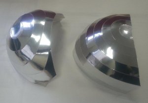

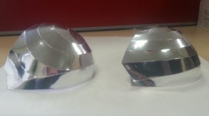

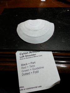

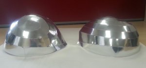

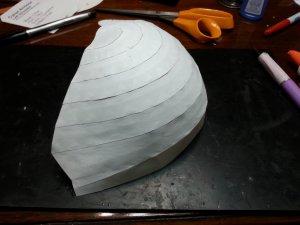

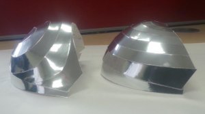

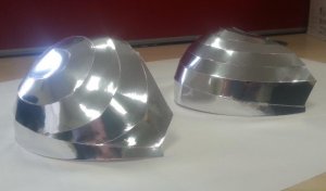

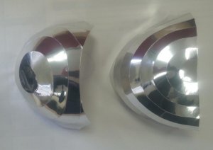

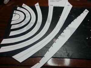

Hi Red, and any other interested parties - quick question.
I'm pretty much 99-100% happy with the parts I've done, except for the shoulder....
I had a go at building it, and found that mine wasn't too fond of keeping it's shape so I decided to try a different design based on a spiral. A slight tweak will be required here and there but it certainly looks rounder, though I'm not entirely sure if the spiral design looks better or worse - it certainly looks more 'interesting' but is that good or bad?
Anyway let me know what you think - all opinions welcome :)
20141029_080356.jpg 20141029_080401.jpg 20141029_080413.jpg 20141029_080420.jpg 20141029_080454.jpg 20141029_080510.jpg

I like the "straight" one better (the one at the right). You can still insert another layer of card to stabilize it --- wait a minute: What about making the right one the outer shell and glue a slightly smaller left one inside it for stabilization?
What about an orange-slice shape? (Well, I'm not too fond of that but it may be worth a try in this particular spot.)
BTW, has anyone started on a new accurate Cylon rifle yet? (The one available as *.pdo is too large and the detailing is wrong.)
11,611
12,352
I thought so, too! I'll swing into action shortly, in other words: the Blaster Master is at your disposal. ;)

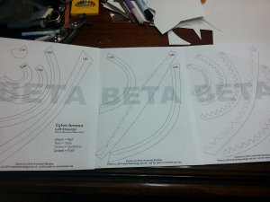

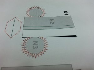

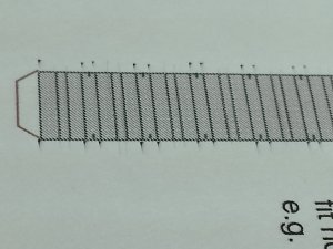

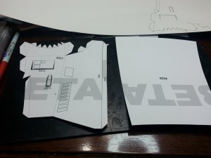

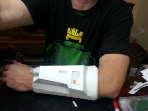

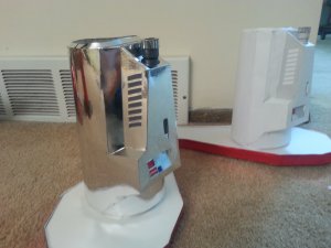

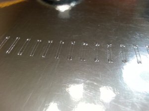

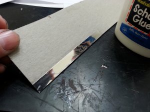

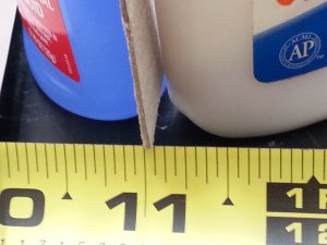

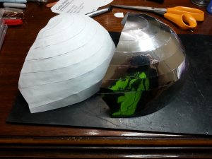

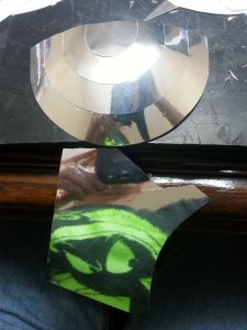

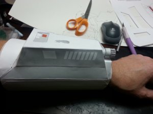

I shaded in the raised parts to help keep me staight on which side of the card I was to score. and after I started bending those tight little bends, the mirror started to flake off the card so I Stopped Bending the Mirror card and started Gluing it to thin cardboard and cutting it into strips to cut it down to size. it could have been the mirror card I was using was too thick,
20141028_213039.jpg 20141028_214331.jpg 20141028_215131.jpg 20141019_124032.jpg 20141019_124459.jpg 20141105_195943.jpg 20141105_202419.jpg 20141031_205100.jpg 20141105_213545.jpg 20141105_213605.jpg
