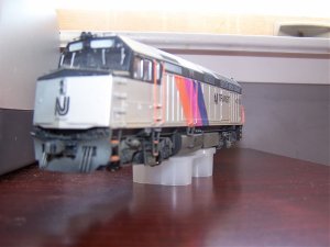

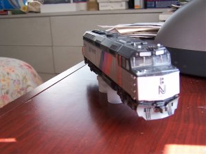

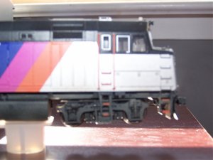

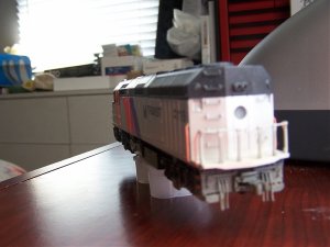

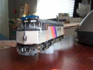

Here are a few pictures of my F40ph wearing NJ Transit Scheme. I know they practically converted most if not all of there f40ph's to F40ph-2cat.
Enjoy the pictures! :mrgreen:

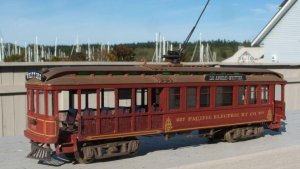

Let me suggest that you study photos of the locomotives you want to detail in order to get the right type of weathering for the wheels and trucks. In the photo below, I became very familiar with the eventual weathering of the trucks and wheels of a car that had been on the road a few years. It is hard to believe that the trucks were painted pullman green when new.
-Ed

Ed makes a good point: even though the wheels on a new unit would likely have rusted faces, the dirt and grime that they pick-up in service can quickly change that. If you don't plan on adding any further weathering, I'd suggest a grimy black for the wheels, as it's less likely to attract attention than unweathered rusted wheels. If you plan on adding airbrushed weathering on the running gear, start with the rust - by the time you're done, the colours will blend together nicely.
Wayne
