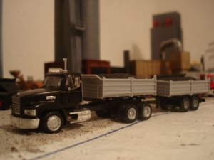

Ok, this Mack isn't really a scratchbuilt model, its more of a kitbash. Here is what it looks like. It is a Mack CH 603 Daycab with extended chassis. I cut the chassis behind the 2nd drive axle and then cut the chassis on the dump body and then glued them together. I wanted to do this because the Red and Black Kibri Mercedes looked out of place among all my american trucks. I added some asphalt to the gravel truck and took the picture out side of the asphalt plant. Here is the old mercedes cab and then the kitbashed version. I still have to add wood sidding to both dump bodies.

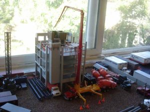

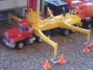

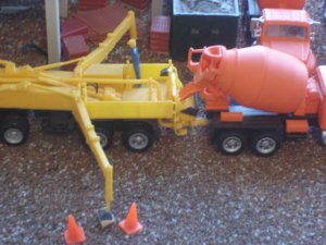

Here is another one I did yesterday. I kitbashed Mercedes Concrete Pumper into a Mack CH 603 Concrete Pumper. I just like the look of those Macks.
