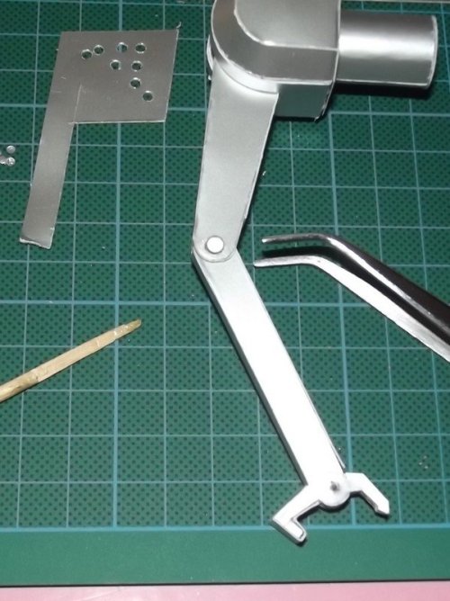

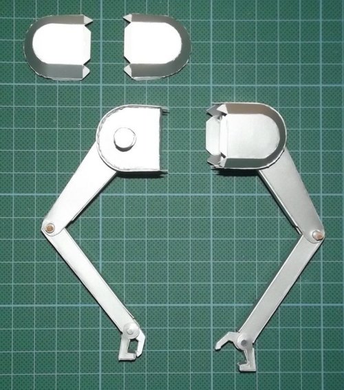

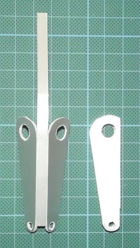

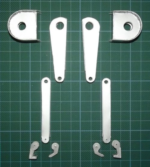

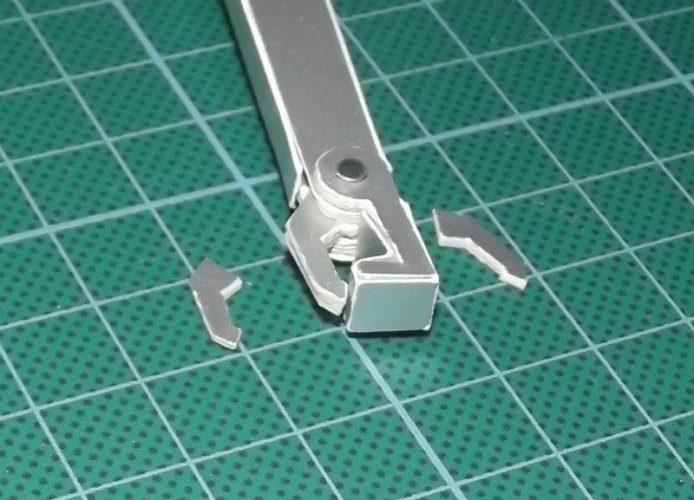

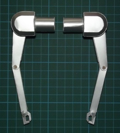

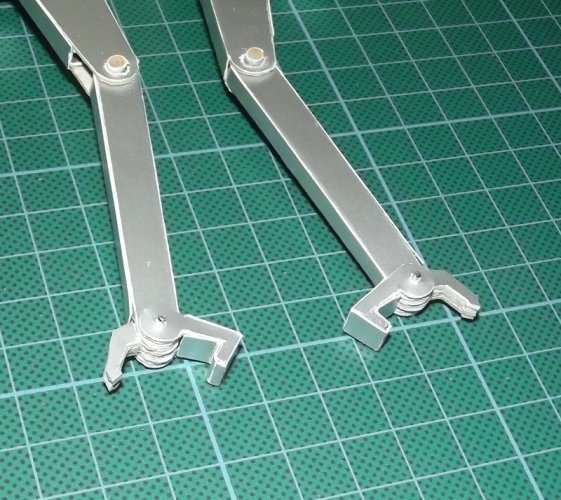

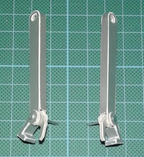

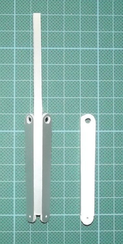

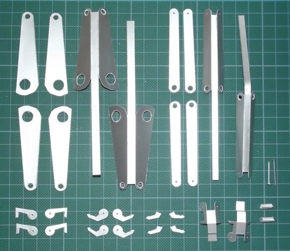

Two arms - and no legs...

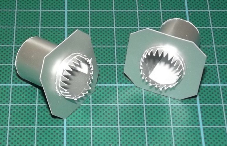

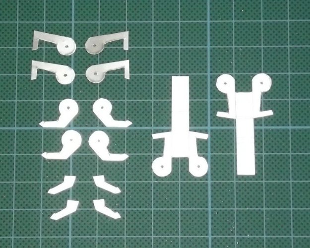

Now then, let's get back to business. Here are the (shiny :cool: !) parts for the arms. Assembly was straight forward, however, I had to use thinner card for laminating because the silver card is a bit thicker than the usual card I used for the prototype.

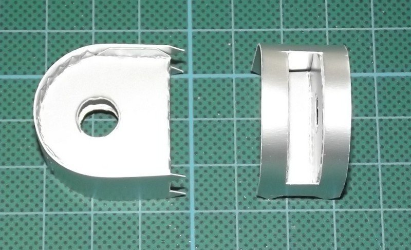

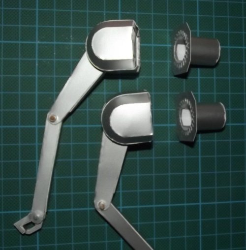

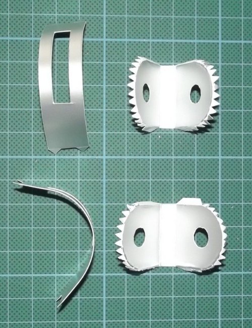

I couldn't use a coated card cylinder for the elbow because the coat started to wrinkle. Instead I used a wooden rod which will be covered by a silver circle later.

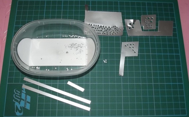

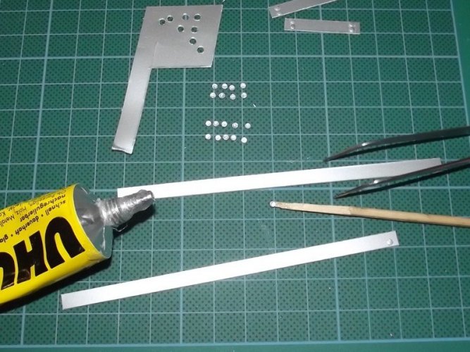

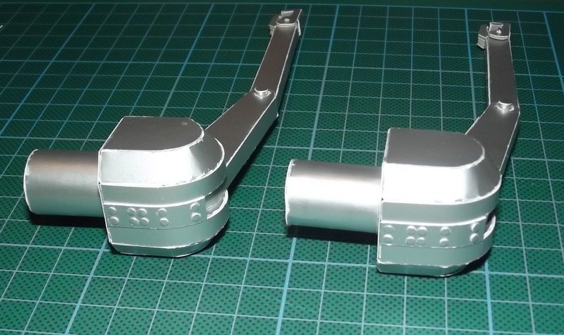

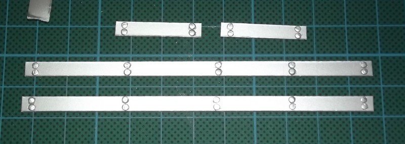

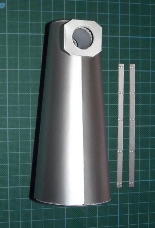

Now it's rivet time. I punched about 60 small rivets out of obsolete card pieces and attached them to the silver strips. The original prop was designed in exactly the same manner to conceil the seamlines of the single parts of the chassis; instead of rivets they used real screws in order to hold everything together.
A few bigger rivets for the sides of the wooden rod.

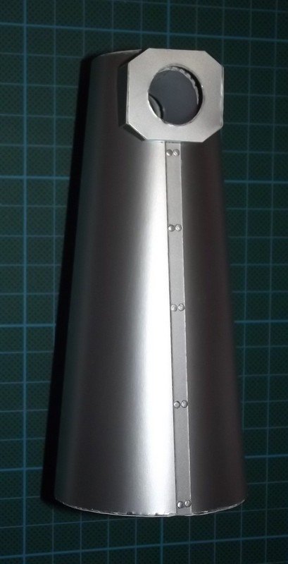

Rivet bands around the shoulders.
They almost look like real rivets.
