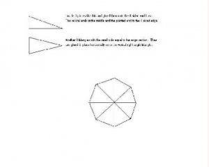

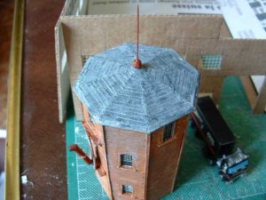

Anyway, my question is - how did you make the roof? I assume from the edges visible in the picture, that it is not a smooth round roof, but rather one made up of sections (6 or eight...?). I have tried a few times to put a roof on my tank, to no avail! I just can't get the pieces to line up... :mad: The roof I have planned is supposed to be made of 12 triangular pieces :(.
Any advice?!?!
Thanks!
Andrew
Matthyro
Will always be re-membered
Andrew. This first photo shows the 8 sided roof. The shingles are paper strips.
Matthyro
This next photo is a rough drawing I did using MS paint and hope it is enough to show you how I did it. Basically I cut 8 right angle triangles with the vertical edge the height of the roof slope. They are glued to the roof base vertically with the vertical edges in the centre of the roof. The next 8 triangles are cut wedge shape and are glued to the roof base along the edges and on top of the right angle pieces
