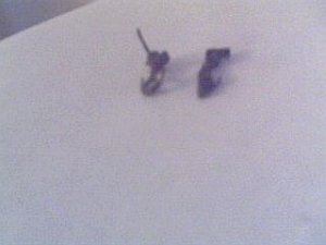

On the under the tree train sets they come with what i call the old default coupler not the knuckle coupler.I want to change them over to knuckle couplers but so far alls iv found are couplers with the big hole to hold them in place.Does anybody know if they make a knuckle coupler with the small hole and where to buy them.I hope I explained it right

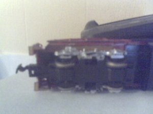

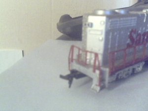

ya looked over there but to be honest this is the first time iv tryed it so i realy dont know what to look for. I upload a few pics of the engine so that mite help Its an old GP 35 runs good [atlas] Im shure it can be done Just dont know what works and what wont

If you've already got a bunch of standard knuckle couplers, the Kadee #212 Talgo Adapter will let you put them in your existing coupler boxes. $2.50 for 24.
