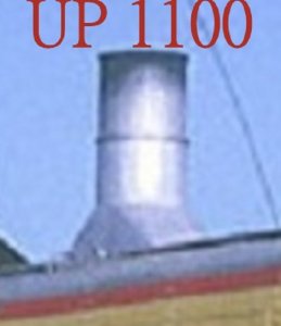

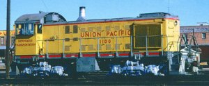

Found out recently UP also had extended stacks on their ALCO S-2/S-4. They didn't do it to all of them though. Some look like they're from Funk & Wagenal. LOL Looks like these could be duplicated w/ my cylindrical stack & maybe a thin band or even a thin decal around the "joint".
