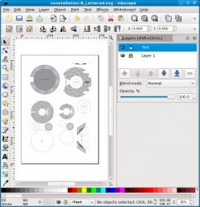

Lettering with Inkscape: how-to
Hello,
:inmew:

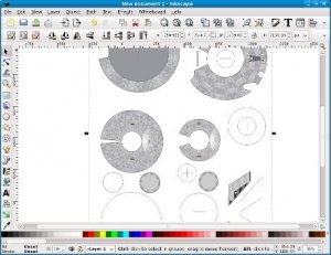

In a previous post, D-WHALE mentioned using Inkscape http://www.inkscape.org, a free vector tool, for converting to PDF. I actually use it for the whole lettering process. Here's a sketch of the steps (I use Inkscape 0.46 for Linux, but there are versions for other operating systems; please note that hotkeys can be reconfigured and change between versions) applied to Zousho's Constellation model.
Create a new Inkscape document, File>Import... constellation-B.jpg.
The original file has a 203 dpi resolution and Inkscape currently assumes bitmaps are 90 dpi, so I losslessly scale the image to 90/203 = 0.44335. With the image selected (F1), click the padlock icon in the toolbar, change the unit drop-down box on the right to "%", type "44.335" in the "W" field, then type Enter. Position the image in the center of the page.
Now do Effects>Images>Embed All Images, Apply. The file's size will increase, but now it can be moved/stored independently of the original jpg.

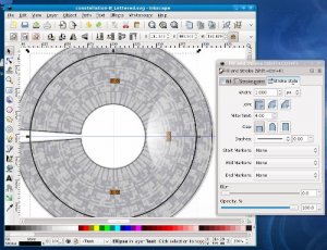

Open the layer panel: Layer>Layers.... Layers are not strictly necessary, but they help avoiding selection mistakes. Leave the image in the default "Layer 1", padlock this layer, then create a new layer above (Layer>Add Layer...) named "Text", and leave it selected.
Drag two guidelines approximately centered on the top saucer part, choose the Ellipse tool (F5).Click on the guides's intersection and drag to an approximate size keeping Ctrl+Shift pressed (this will keep the ellipse circular and centered). Object>Fill and Stroke... opens a dialog to adjust the curve's color and thickness. Click the "X" button on the Fill tab to make the ellipse hollow.

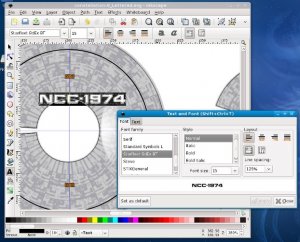

Choose the Text tool (F8) and type the registry number. Use Text>Text and Font... dialog to set the font - I got Starfleet Bold Extended at http://downloads.outpost10f.com/font.html - and approximate size.
Select both ellipse and text, then Text>Put on Path. By default the text will go on the outside of the curve. To fix this, select the ellipse, Path>Object to Path, Path>Reverse.

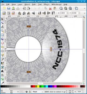

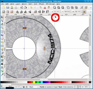

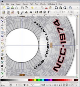

Click twice on the ellipse, changing its handle to rotation arrows. Drag one of the arrows till the text is approximately centered.
Fine-tune the size of the text and radius of the ellipse (the latter is easier if you type in the "W" field beside the padlock, since it keeps the curve centered). Large text inside a curve is usually too tight, so insert some manual kerning between the characters (position the cursor, then Alt-arrows). You may rotate the ellipse again to recenter the text.. When satisfied, make the ellipse invisible by selecting it, Object>Fill and Stroke... and clicking the "X" button in both Fill and Stroke paint tabs.

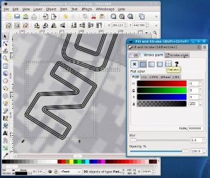

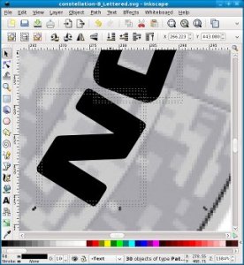

Now select the text, Path>Object to Path, Path>Break Apart. This step is necessary because we must color the red outlines. From now on, the characters are only curves and cannot be changed any more as text - therefore if you want to build a fleet of Constellations, add the name (see ahead) and save before this step!.
Select all character paths, Object>Fill and Stroke, click on the "X" on the Fill tab, select the plain color square at the Stroke paint tab, then choose a thin width at the Stroke width tab - this will make easier selecting individual paths.

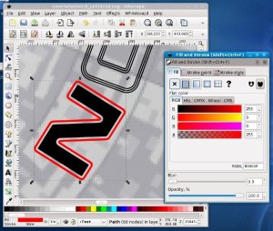

The ex-character "N" has three paths which we'll call A, B and C, from inner to outermost. First we must create a new path which is the difference of B and C (i.e., a hollow, futurely red, outline). Inkscape can create path differences, but the inner one must always be "above" the outer one. So select B, raise it (use the toolbar buttons, or Object>Raise to Top), select C, lower it, select both, then Path>Difference.
Now Object>Fill and Stroke, choose a red fill and no ("X") stroke:

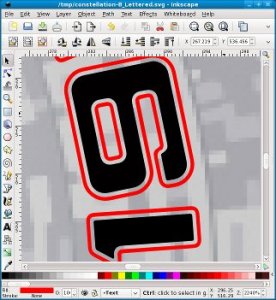

Repeat on all other characters. "Holes" in "4"s and "9"s are handled in the same way.

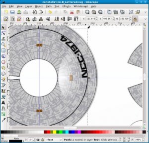

Insert the ship's name in the same way. I used the Federation font from the same source, and since it has no outlines, there's no need to convert it to paths now.

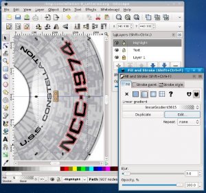

Finally let's simulate a subtle headlight highlight. Create a new layer "Highlight". Select all objects in the "Text" layer, Edit>Copy, select the "Highlight" layer, Edit>Paste in Place. Temporarily hide layers by clicking on the eye icon to make sure the copy is there.
We want a semitransparent, blurred shape partially covering the text, but not the texture underneath:
  • convert the ship name's copy to a path
  • select this path and the registry number's copy, Path>Union
  • create a filled ellipse roughly matching the white highlight in the texture
  • select both united path and the ellipse, Path>Intersection
Now fill this shape with a linear gradient, opaque white on the left and transparent white on the right, blur it slightly, and unhide the "Text" layer:
Repeat on the bottom saucer, then File>Export Bitmap. Select Drawing. Optionally convert to JPG, or print to PDF.

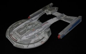

I didn't build the Connie yet, but this is Zousho's Thunderchild which I lettered and built at 70% scale (since I printed at only 300 dpi in plain paper, caring about the hollow red outlines was probably overkill). IMHO the ship looks boring without the name, so I included it even though it appears anonymous on-screen.

In part 2, I obviously :eek:ops: forgot to mention that, after applying the red outline, the innermost path A should be filled with black, and the stroke removed.

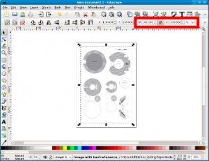

The original file's resolution is 203dpi, and Inkscape assumes imported bitmaps have 90dpi, so the image object must be scaled down by 90/203 = 0.44335. Select (F1) the image, click the padlock icon in the toolbar, change the unit drop-down box on its right to "%", then type "44.335" in the "W" field on its left, and type Enter. This will change both W(idth) and H(eight) to the appropriate size. Either manually position or use the alignment tools to center the image on the page.
By default Inkscape links to bitmaps. Do Effects>Images>Embed All Images, Apply; it will greatly increase the Inkscape file size, but now your work can be moved and copied anywhere no matter where the original bitmap is.
In order to avoid accidental selection, it's easier doing everything in separate layers. Open the layer panel Layer>Layers... Leave the bitmap in the default "Layer 1" and lock it with the padlock icon; create a new layer above it (Layer>Add Layer...) named "Text" and leave it selected.
Drag two guides approximately to the center of the top saucer part, then select (F5) the Ellipse tool. Click on the intersection of the guides, and drag an circle of approximate size, keeping both Ctrl and Shift pressed, to keep the curve circular and centered. Object>Fill and Stroke... opens a dialog to adjust the curve's color and thickness; on the Fill tab, click the "X" button to make it hollow; on the Stroke tab, give it a contrasting color, we'll make it invisible later. You may also do that using the bottom toolbar.
With the Text tool (F8) type the registry number. Open the Text>Text and Font... dialog to choose the font and size. I got "Starfleet Bold Extended" at Outpost 10F, http://downloads.outpost10f.com/font.html. This font has proper outlines, but all in one color and as superimposed nested paths. We'll make the outlines red later.
Select (F1) both ellipse and text, Text>Put on Path. By default the text goes on the outside. To fix that, select the ellipse, Path>Object to Path, Path>Reverse.
