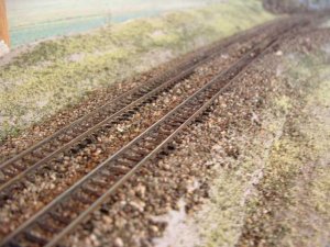

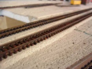

I have posted these photos elsewhere in a thread started by Jim Cullen but this is of interest so here goes.
I paint all my track with acrylic burnt umber that I brush on. It looks a bit dark but ince ballasted it looks fine.
First photo brush painted track.
ezdays
Out AZ way
Robin,
Thanks for the pictures. The ties in this area seem to be darker as well, but the rails are kinda a rusty red. I've been playing around a bit on some samples, and I still haven't gotten anything that I am satisfied with, so I think I'm going to try a few different techniques in different parts of my layout. I have a feeling that balasting makes a big difference in how things look so I have to get past that step to see what the final results are anyway. I am just now finishing the wiring on my track and once I've had a successful test run, I'm ready for some track painting.
Don
