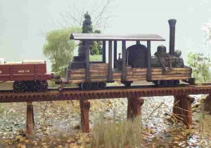

I see you purchased a G scale model of the Climax.
The only climax I have is the Bachmann On30. I have a conversion from an MDC HO shay to On30 climax, that Shamus built, it is one of my prize possessions.
