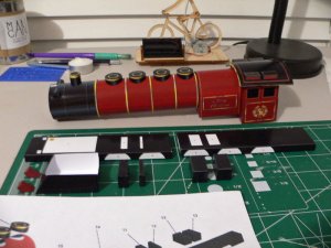

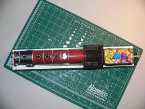

Looks like a big AA battery at this point.
Had a brain fart here. I cut out the first of the 5 gold bands that wrap around the main tube of the train. I had no idea what so ever what to do with it based on the instructions. :cry:
The band must be 3D so I folded it at each line which made a three sided "box". Cool - but without cut outs there is no way to wrap it around the circular body of the train. I settled by folding and gluing the three sides together - sort of rolling it - so it came out flat. This worked but took a lot of time so for the the last four bands I cut so I only had to fold it once instead of twice. In other words I cut off one of the three "strips" so only two were used folded in half. This leaves the back fold exposed with the paper edges - I used a yellow marker to help mask this. Yes - my builds look better the farther away you get from them! :thumb:
Not too bad - first band with all three strips is a little thicker.
Almost done with the second page of instructions.

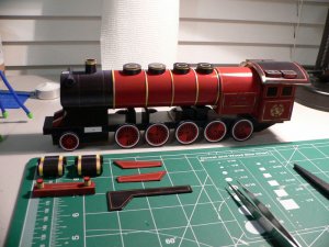

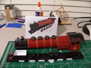

So back at home and have now completed up to page 3 of the instructions.
(These pictures were enhanced so they would not be so dark.)

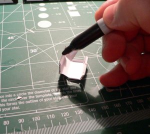

Coloring the edges. This hides any "cracking".
Bottom frame assemblies completed. Nothing too hard here.
Bottom frame completed
On to page four....lots of wheels coming up...

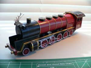

Finished!
Well, actually finished on Christmas Eve and I must say this was a really tough build. Being a beginner I was not entirely sure if some assemblies were missing tabs or not. I know there is a technique of not using tabs, but at this stage I prefer the tabs – especially when trying to finish by a certain date. The instructions really added to the “puzzle” challenge of this model. If you plan to build this model and like a good challenge, stop reading now – I guess this would be a spoiler warning…

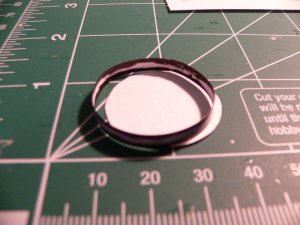

The wheels were difficult since there were no tabs. On some I forced one “circle” into the “ring” which helped make the wheel round (or at least as round as I cut the circle). The forced circle was then pushed down flush with the edge of the ring and then glue added on top of the “seam”. The other circle was then glued on the top edge of the ring. This did not make for a very secure glue connection. On some I ended up making “tabs” to help strengthen them.
Several of the other parts did not have tabs either - of course I found this out after cutting and folding several of them – ended up reprinting and drawing in the tabs – this really helped in securing the pieces. An example of this is the rails – they look like they have a tab but that is just the bottom glue surface.
Part number 30 had me stumped for a while – I was not sure if they were supposed to be 3D or flat – I made them flat – I think I guessed right?
Unfortunately I did not review all the way to the end of the instructions – always, always review to the end! The deer heads should NOT be attached to the train until after both wreathes have been built! I did not want to tear the heads off and since there was little time left, I made the wreathes 2D – this let me cut a slit and slip them around the head. Definitely does not look as nice as was intended - but better than nothing and I was pressed for time – yeah, that’s the ticket. Since the deer wreathes were 2D, I made the last two on the car 2D as well to match. Who is to say the wreathes were not painted plywood instead of real wreathes?
This was an excellent model and was a great learning experience – I really recommend giving this one a try.

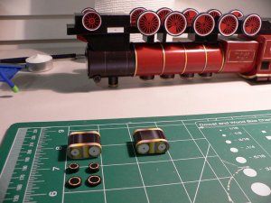

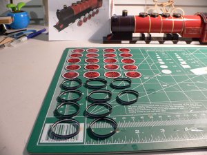

A wheel - face on the side or inside?
Plenty of wheels to do
Wheels drying

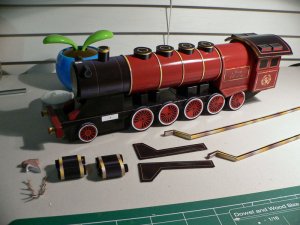

More parts
And more parts...

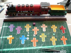

Finished engine

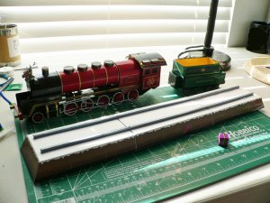

Track is ready
Now to make the presents - may want to make more for a fuller effect.
Finished!
