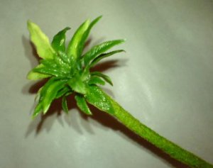

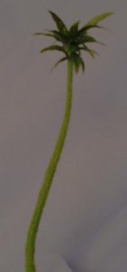

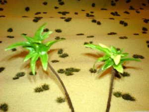

Hi,
I was in need for a few palm trees. Only a few commercial produced are available and those are announce1EXPENSIVE! I found only Heart of the South Models, Woodland Sceenics and Preiser making palms. Preisers palms are the cheapest of all three (in Germany), you get 4 for 10€ as kit. But if you need a lot of palms it will become expensive.
OK, I found a way to model what I need:
In the aquarium corner of a home improvement store I found a plastic (vinyl) aquarium/terrarium plant. The leaves are looking like palm leaves. The trunk is from a different plant I've got in crafts store, it's basicly a couple of wires covered with plastic and fibre grass.

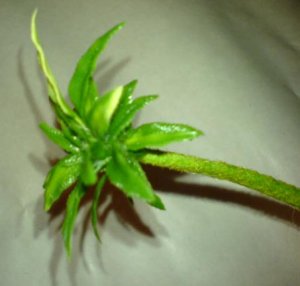

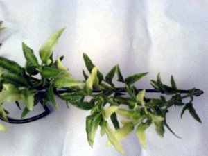

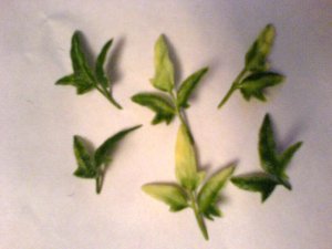

- Bend the trunk.
- Cut the leaves from their trunks.
- Prepare different sizes of leaves.
- I started with some of the bigger ones and glued them around the trunk. They will support the other leaves when glued on.
- Because of the vinyl the leaves are made of, ca glue don't work well. I used a special glue for PVC, acryl and plexiglas.
- Glue the leaves to the trunk, use prototype photos as a guide how and where to glue them.
- If will not satisfy a botanist, but for me it looks like a palm.

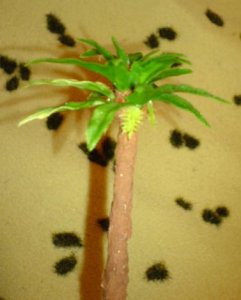

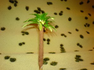

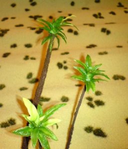

caliban
May 3, 2006
139
49
Lower-Saxony, GERMANY

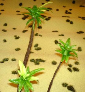

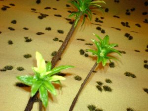

Thanks Jim!
I painted the trunks brown, it's the first layer of paint. After adding the paint to the trunks, they look more like real palm trunks. The background is a "desert grasmat" made by Preiser loooong loooong ago. Found it today in a lhs in a neighboring village, hidden in a corner. Cool old Preiser stuff, love it!!!!
