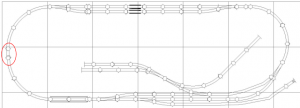

I was wondering if anyone has built the Carolina Central layout that was in several issues of Model Railroader, and also in the Model Trains Step by Step special issue. I was looking over this layout and have decided that I am going to build this as my first layout. I was transfering the pattern into a copy of Right track that I downloaded from Atlas, and am having a problem, as I cannot get a couple of parts to line up correctly.
Any help would be greatly appreciated, as I would like to be able to print it out and use it for a template so I could possibly get some of my landscaping details decided on before I actually start laying any track.

I have read through the article many time, and closely examined their trackplan in the magazine, I found that the problem was that I needed an extra piece of track that was not called for or shown in order for things to line up correctly.
I will try to attack a picture of what I am talking about. I circled where I neeeded to ad a 2 1/2" piece of track.
If anyone has any suggestions or words of advice on wiring, please let me know.

I don't think I quite get what your saying.
Do you mean to use flextrack instead of the curved sections on the Left of my image, where I have the piece circled? or on the other side?

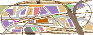

I took the basic plan and added some city switching to it...

The loop has a switch on the lower right side that puts a straight piece into the curve at a 60 degree angle. If you insert a straight in the upper left quadrant (same angle) that would balance it perfectly with sectional track. The other option, to put the straight in the lower left quadrant, would mean that you need a 1/3 straight in the lower straight section to balance it.
The straight in the upper left quadrant would look similar to gringo's layout.
