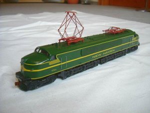

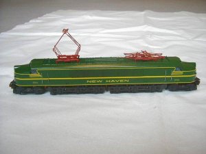

I found these 2 photos on the Atlas Forum, a Frateschi electric painted and modified to look like a New Haven EP4, by Acela 82. lv4142003

It's not my engine. I saw the picture on the Atlas Forum and remembered someone here had speculated what the Frateschi engine would look like modified to resemble a New Haven EP4 (or is it a EP3?). The Guy who did it goes by Acela82 and he did a nice job. Very few people would know the difference (see my parenthesis above- I'm one of the ones who wouldn't know), so I copied the photo and brought it here. lv4142003

A friend of mine just told me "Michael, your EP-4 is in the gauge forum!"
Yes, i built this engine, it was alot of fun. As you mentioned, its not that prototypically but overalle it looks like the prototype. If you have any questions or suggestions feel free to write...
Chris, its not powered from above, but it runs very well. I will add an decoder someday, i have other projects on my workbench first.

Thanks for your comments, here is a little how to:
The engine started as an undecorated single Headlight EP-8, i got it a few months ago. First thing was to grind away all those on-casted fans, handrails etc. I closed the old fan holes and doors with putty and grinded all smooth. A sheet of thin evergreen styrene was used to built the new corrugated fans. A first problem occurs when thinking about the doors. The prototype ones are deepened in the hood, that means lot of work on the model: cutting out the door area and built new ones to install them from the inside. Too much work, i decided and built new ones from thin sheet styrene and glued them on the shell, from the outside. Same problem with the handrails, as the real ones are also deepend in the shell. Too, i installed mine on the outside. That was all regarding the shell. When looking at the gear, i noticed that it is different from the prototype, so my first thinking was to add the complete gear from an IHC GG-1. This one did not fit, as the GG-1 is longer. So i decided not to change the gear at all - its black, so when the engine is on my layout, you can´t see the differences. I painted the shell with a dark green and added decals from Microscale. I reused the original pantographs, but i shortened the contact shoes. After all, i added a slight weathering to the fans, making the curragating looks better.

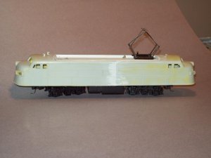

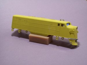

It's been quite a while since this thread has had any additions. I finally purchased a few Bachman F7's, the kind they use for the "Grinch stole Christmas" set and some others. It has no portholes, no intake screens and no rivets. I've spliced 2 of them and set them on an Athearn F7 chassis. I am using Bob Hegge's MR article from 1957, with differences. I am using the newer chassis and replacing the EMD truck sideframes with GE's, they look more "electric-y". I havent figured out how to make and attach the "porches" yet, but they will have to fit in/on the coupler mounting pad for swing from side to side. As soon as I figure out how to post my photos of the unfinished product I'll post them. lv4142003

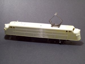

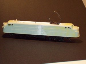

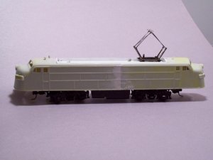

I think I'll be able to send thephotos of where I'm at so far.
The 1st photo shows the Bachman body stripped of the graphics. You can see it has no intake grills, no portholes and no rivets.
The 2nd through the 4th show the splice and putty job I did under different lighting conditions, hopefully they show up well.
The 5th photo shows there is a slight mis-alignment of the battens. It appears that Bachman have 2 different manufacturers for this body. There are differences in the width of the battens and their placement and some differences in the windshields. Nothing I'll lose sleep over but something someone might like to know.
You can see I'm using the modern Athearn chassis and the EMD truck sideframes, but they will be replaced with GE sideframes as soon as I find my stash of Athearn trucks. The porches will be next and they will attach at the coupler mount provided. I still need to find suitable "electric" looking trucks for under the porch. Bob Hegge initially used MDC trucks, but I've had no luck finding a set yet. I;ve built a tray in the roof after cutting the fans out. It will require a samll elongated box positioned between the pans. The pantograph is from a Bachman E33 and I only have the one at the moment, but I call Bachman every week to see if they received any in as parts or from returned items. They look really good. lv4142003
