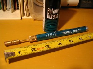

I find, sometimes, a small torch works better and faster than there electric cousins. I have a pencile torch that has a real small flame. These pencil torches are so small that they are over looked by conventional craftsmen as being to small, so you can get them for 5 or 6 $. Those Burns-o-matic models are made primarily for plumbing work and produce to much heat for small work.
That's what I think.
TrainClown ;)

I have one and like Jon says, it is only good for big jobs as the flame, even though tiny, spreads out some so makes fine soldering difficult. I haven't seen one like yours TC.
