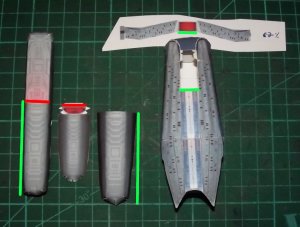

I've found the old files of my Wanderer class build again. Now I can tell you exactly what went wrong with my build. First, the neck which combined the saucer section and the engine section was too big. I resized it to about 57 % which should fit. The impulse engines on the warp nacelles were too big, too (the parts with the red lights). I reduced them, too. You'll have to check the length of the (grey-blue) cover part and maybe resize it a bit to make it long enough to cover the nacelle. Unfortunately the main parts suffered from bad storage conditions and cannot be used for completing the build; I guess I'll make a new one soon.
I have attached a small pic showing which dimensions must match (green-green / red-red).

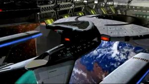

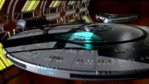

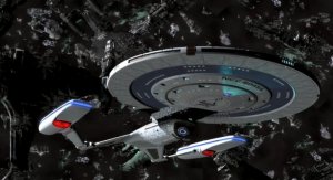

And here are some screenshots of the Helena in action. Enjoy!

I don't have the nacelle scaling problem, seems like your sheet 2 and 3 didn't have the same scale perhaps ?
The neckpart is a problem though. When you scale it down and would assemble it the way it is then the dish would be tilted because the neck doesn't line up correctly.
I'm making my own custom neck perhapes a bit more detailed to.
This model is turning into a "one of" though, not much standard right of the template anymore.
In your pictures it shows that you assembled the 3 main hull parts allready.
I ran into problems when I first did that because the back part with the hangar opening doesn't line up with the main deck that you'll have to partially insert into the hull. I had to up-scale the backpart of the hull to 125% of the original and custom-fit it to the assembled upper and lower hull and deck. (do I make any sence ? :mrgreen:)
Yes, I completely understood :thumb: . I don't know any more if I had a problem with that part; I started my build almost three years ago so my memory is a bit foggy about that. What you said about the different scales of my parts pages might be true. I was thinking the same. Anyway, I won't continue this build because the main parts were crushed due to the lack of formers and a bad storage (it was one of the first paper models I tackled after a long time). Instead I will make a new one soon to find out what exactly went wrong and to correct the parts which don't fit.

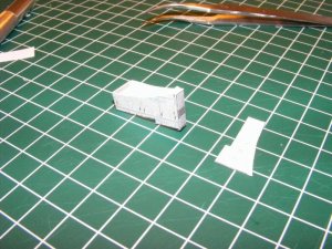

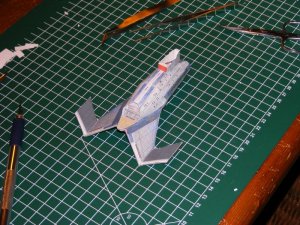

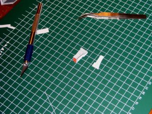

Next update, the neck episode....
As I said I made a template for the neck part.
I used it for cutting out the right en left side of the neck, I printed some hull plating textures from another part of the model for that.
The first pictures show the assembled neck with the template laying in front of it.
I also made a custom scale impulse engine and frontside of the neck with the photon torpedo tubes.
It turned out great and after setting it to the hull I could hold the saucer on top to see if they alligned correctly, and they did ! :mrgreen:
I allready made some custom impulse engines to the saucer but forgott to take pictures of that, you'll see that in the next update when I put the top and lower part of the saucer together.
It's been a lot of work to get the neck just right, making a custom one alltogether was easier than using the excisting parts though.
I'm now going to finish up the saucer and start with the nacelles.
Cheers and thanks for all the compliments.
